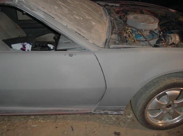

here you go people
here is a shot of the passenger side after a quick shot of primer to keep the rain thats moving in from rusting the whole side of the car that i got down to bare metal.
and yes i know the ground effects isnt done i wasnt to worried about that because i wasnt done sanding those down yet.
shot #1
shot #1

hey man i would not recommend that paint!!!!!!!
the saying u get what u pay for definately goes for paint!!!!!!!
we got some cheap junk here sold by auto body store for like 50 a gallon or less called westerns auto.
its junk. it wont shine wont last nothin.
weve done 2 cars w/ it one fullsize white chevy after a year or so no buffing just hand waxin that sorta thgin had some shine but showed the paint underneath or somethgin cuz it had brown spots.
they werent there when it was done just started showin up waxin n junk wouldnt help it any.
we done a van in the silver supposedly.
my dad done it i was too young but i argue him up n down that van is not silver its brown or dark green or somethgin no lie its aweful!!!!!!!!!!
he swears when they done it it was silver n so did other ppl but within a year it had faded n turned **** brown no shine wont buff up nothin its the most aweful paint ever..
so id say any other paint would be too i was goin to buy some off ebay for 30 a gallon but my dad talked me out of it because very car done w/ cheap stuff was just that looked and was cheap looked like big time crap.
oh yea nice shiny n clean ocne done but after month or so started showin age quickyl and badly.
turnin dull and even changeing shade.
w/ black i doubt it change it get dull and maybe turn to primer black /flat black look alike or dark grey if anything.
but come to think of it the fullsize in white n van in silver both were turnin ****ty brown so that paint i dunno i wouldnt trust it less it was just to cover body work so u could get rid of the car asap.
i never seen ppl use clear coat over acrylic enamel because as it says it dont need it and u can buff it up to be nice.
if u spray the enamel or color down then use any kinds of compounds u wont be able to clear it yull have to wet sand and then wax/grease or prepsal as its called the whole car.
which would defeat the purpose of buffing the color now jsut wet sanding it thats fine cuz u gotta smooth it out or let it dry before clear coat?
bc/cc paint u dont u do color then spray clear over it w/ flash time but still a lil tacky or completey dry man its been botu 2 yrs since i used bc/cc im not sure.
anyoen knows if u have to let the bc dry before cc plz post it so we know for sure.
if u do have to let acrylic dry before clear then definatly sand it so its smooth but save the final wet sand and buffing for the clear coat.
paint im goin to buy is a lil unfamialr to other ppl but is great paint its centari brand.
its costly but i think if im not mistakin cheaper then sherwin willams and dupont but tis great paint lasts about forever.
even that fullsize we done it over w/ white centari brand acrylic enamel, it set for over 2 or 3 years n turned dull and green due to dirt n mold n junk i took a brillo pad n scrubbed the whole truck w/ it u could see white in the water when i was done liek wet sanding it. took some wax and buffed it off w/ buffer shined just like when ws 1st painted.
thatw as the 1st time that truck had ever been waxed as well.
we drove it for around 2 or 3 yrs before parkin it w/o waxin and stil shined like fresh paint w/o wax just normal wash .
i **** u not my friend honest story no lies.
i have no checked the price on the dupont or williams paint for wht i want on my car for comparison for prices mainyl because my dad used centari many times and ive seen the results kinda if it aint broke dont fix it.
i want to paint my car n not worry abotu shine a year later or so. do it right do it once sorta deal so i stick to my guns n go w/ what i know is tried and true and been tested n personalyl seen the results so i stick w/ centari brand.
for dads s10 red its 57 a quart for paint alone so like 175 or so for a gallon i think no more then 200 i think
mines 125 for gallon of big flake silver metallic.
its definately worth the cash tho.

I done a little more today
started going over the entire car to make sure everything is perfect no dings or anything,also bought my paint supplies today 1 GALLON PPG OMNI BLACK ACRYLIC ENAMEL
1 GALLON OF REDUCER
1 PINT HARDENER
I GALLON OF HIGH BUILD PRIMER
just finishing up final touches all over the car ,reprime , wetsand let dry go over entire car with grease & wax remover,tack rag it, setup paint booth, go to spraying. I promise to take pics of in progress during me spraying and after.
thanx,
thomas
