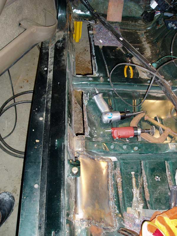

Yeah, that's not bad at all! My '92 started out MUCH worse:
(that's all metal I had to cut out to remove the rust in the floor. That doesn't even show the parts of the rockers/cowl I had to repair)

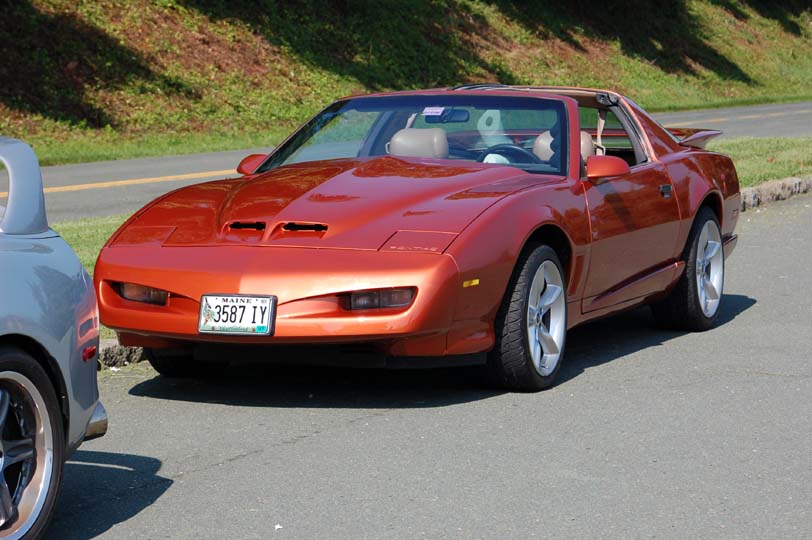

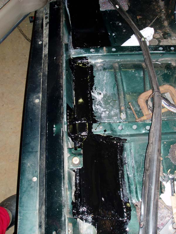

I cut out all the rust, welded in new metal, and POR-15'd the whole undercarriage after installing my subframe connectors to turn her into this:
All that to say, you have a GREAT LOOKING foundation for an awesome car/project. You've got some great plans for it too from the sounds of it. Since I changed the color of my car I stripped EVERYTHING out of the engine bay, and sandblasted it (and the door jams) down to bare metal. I then sprayed the engine bay and door jams the new color and re-assembled everything before painting the exterior. In my opinion the exterior paint should be the last thing after you've gotten the rest of the car assembled, but if you paint the engnine bay and door jams before re-assembling you can be careful during assembly to keep from damaging the paint in those areas.
