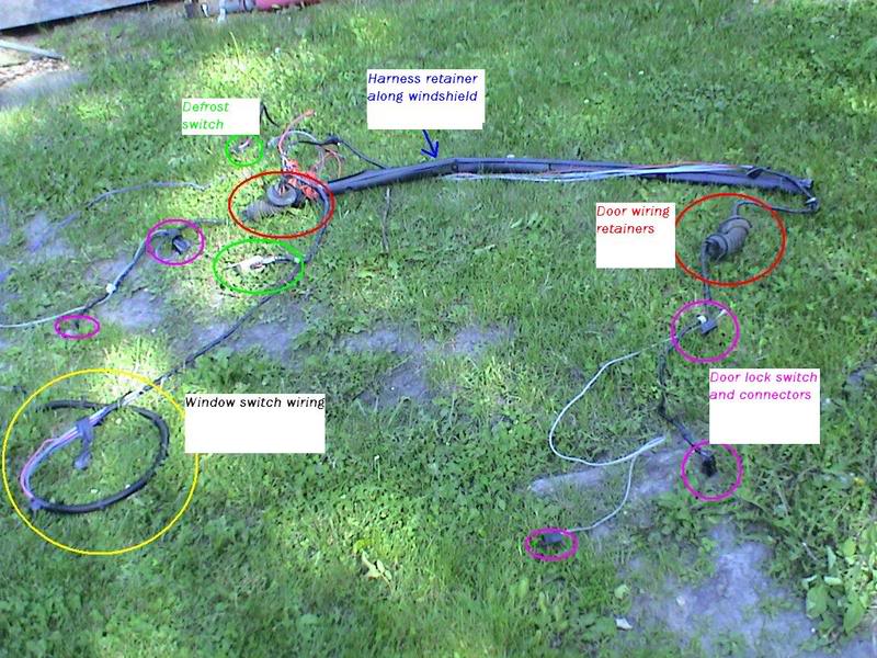

To switch to power windows it's probably best to pull a wiring harness and switches out of a donor car from a junk yard or something. It runs along the front just below the dash pad. It's best to do this before swapping so that you can operate the window/s. The harness also includes the pieces that go in between the doors.
