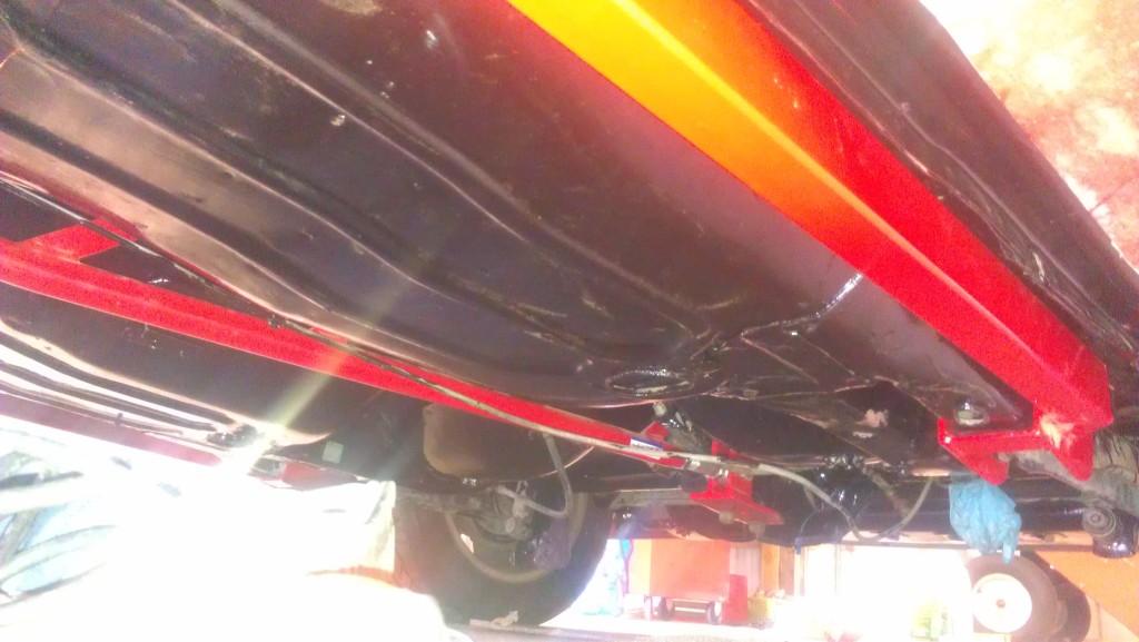

A better picture to show how clean this car is underneath it Name:  IMAG1110_zps6977fc11.jpg

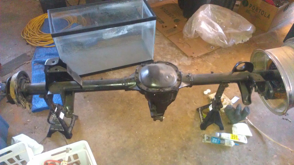

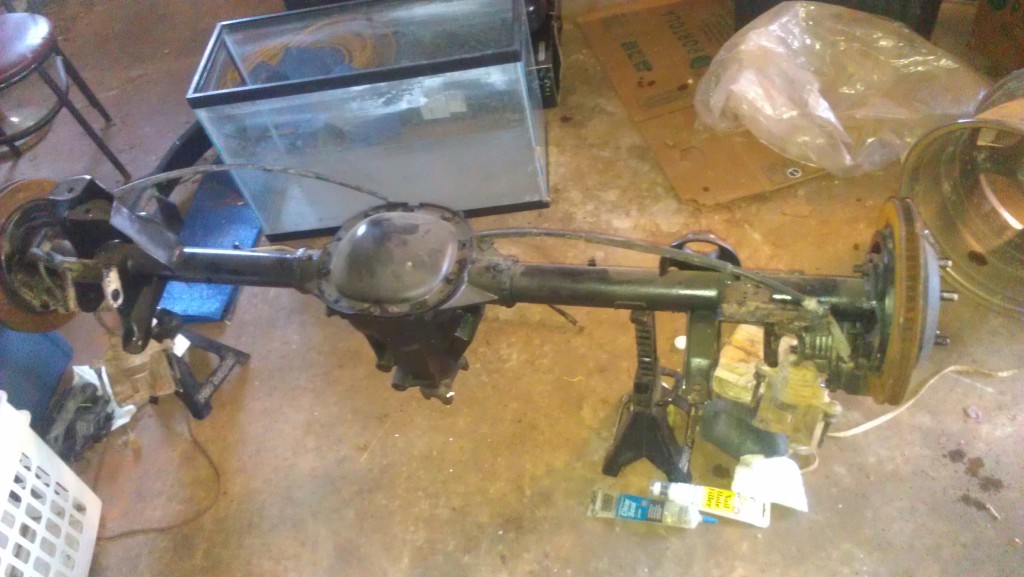

Well got some progress today... Took the rear out and part and paint will be here Thursday

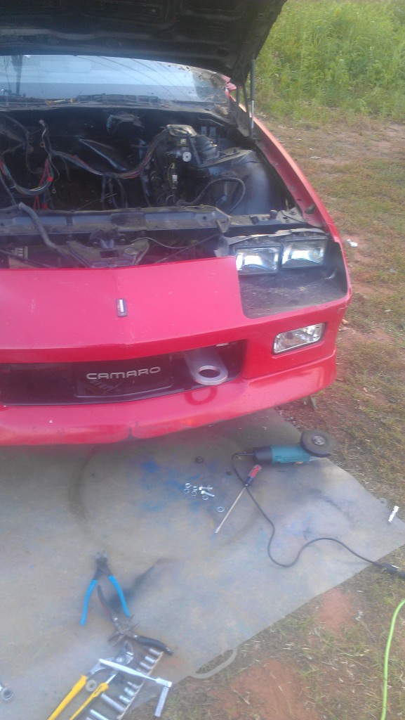

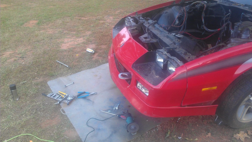

Originally Posted by 91camarosRS
ok so back to the 4th gen pedals... who said they were a bolt on?! i cant get the top vertical bolt to line up with the hole!
also anyone know how to take out the top 4 nuts on the front bumper cover so i can take it off?
If you take the inner wheel well skirt out, you can then go in with a socket and extension to remove the 4 nuts, if they turn on you, then take a screw driver with a rag and pry a little between the nose and fender. This is how I get those upper 4.
Nice build, sory to hear about the white one.

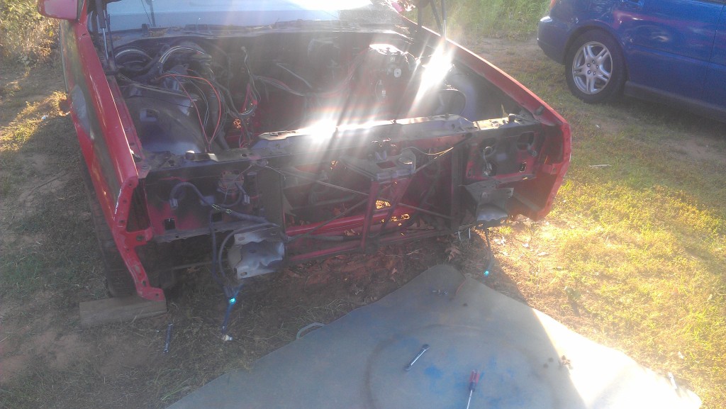

Size:  246.1 KB getting some welding done today! Lcarb and SFC

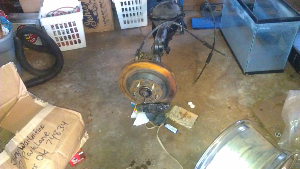

Been busy lately but I got one side done on the drum to ls1 disk!
