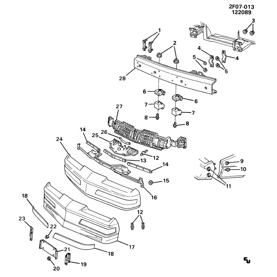

Sorry if my description was unclear.
In the following picture, parts 25 and 16 have some surface rust on them.
They are most definitely metal.

Kinda wish mine was plastic. LOL.
'89 Formula. Filler panel is heavy gauge metal.

Re: Repair or Replace the Filler Panel?
Media blast or sand, then repaint.
