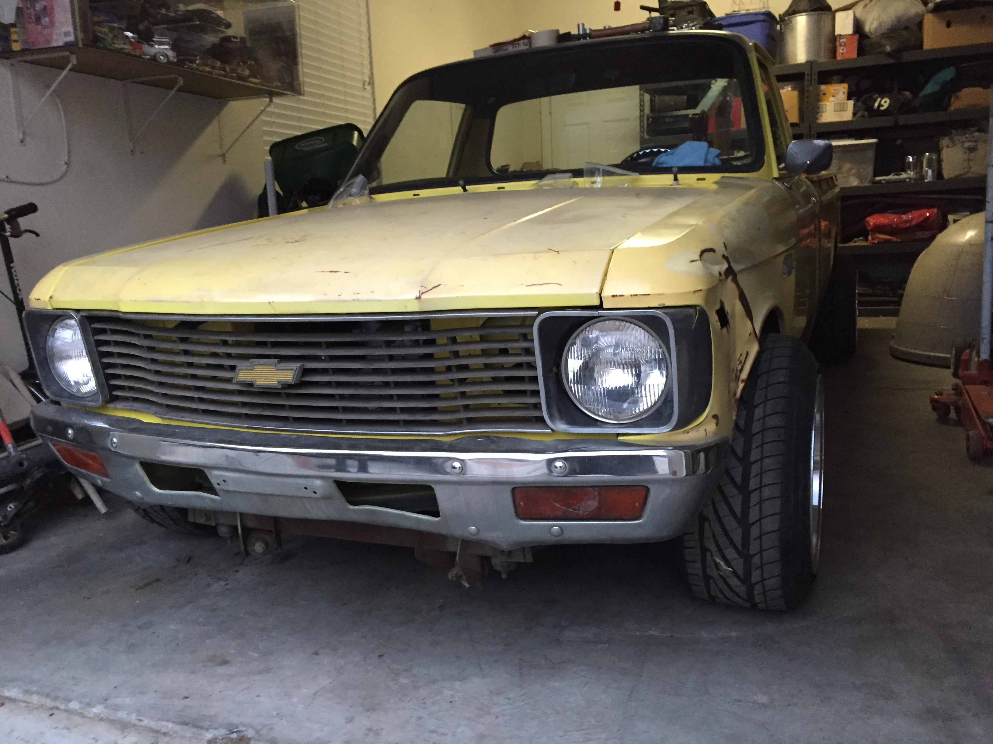

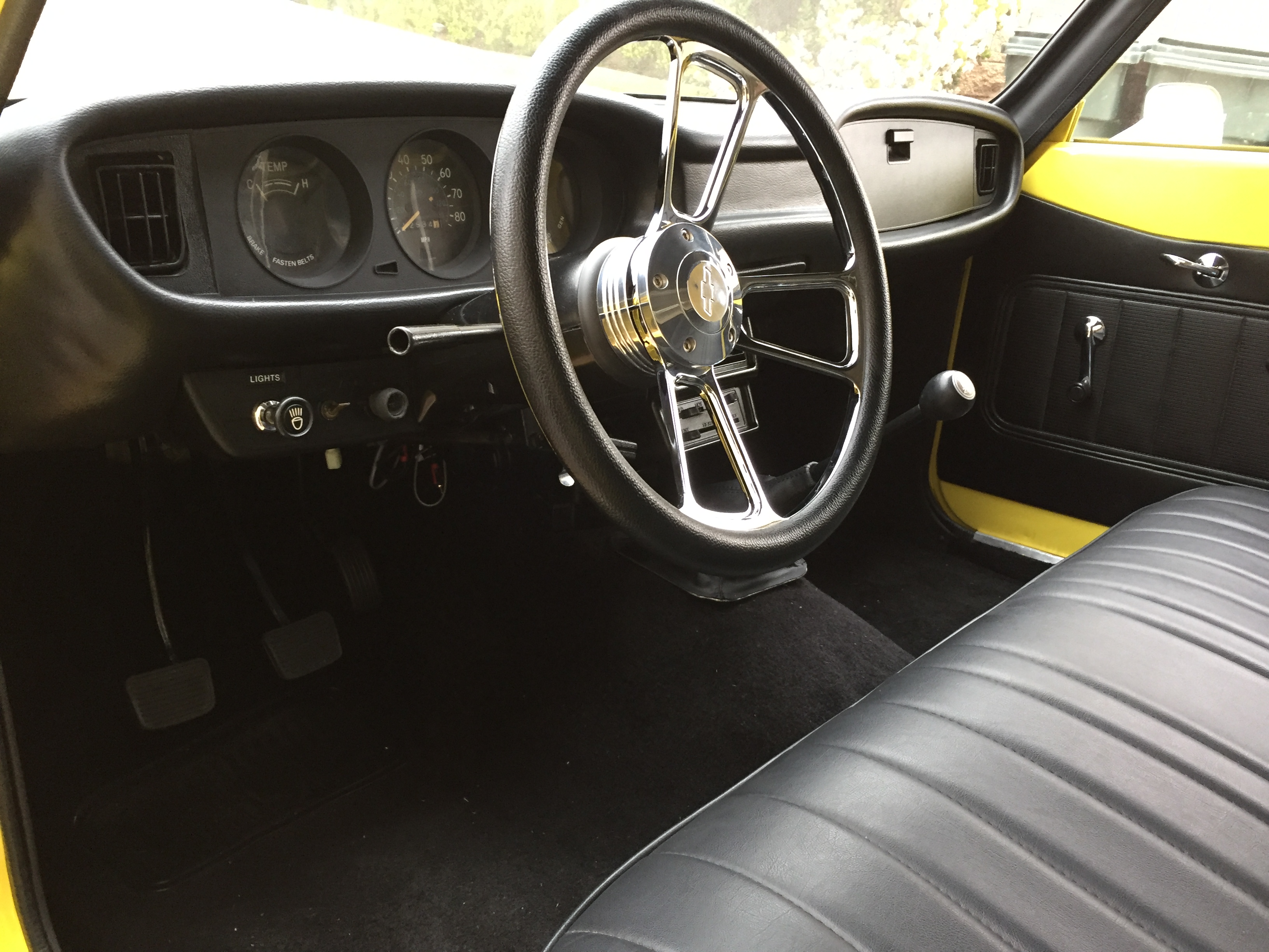

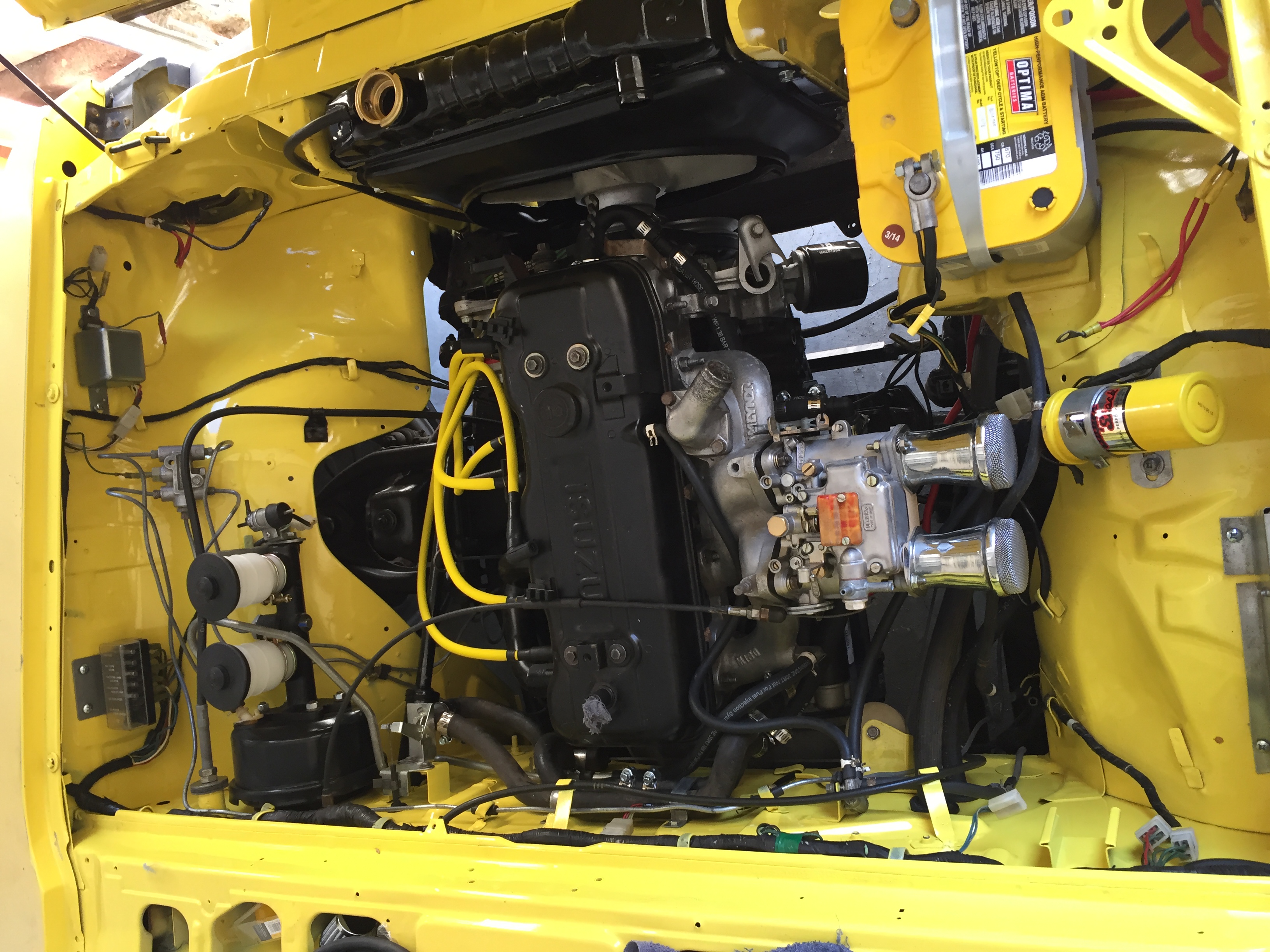

Thank you. The Luv is another project that I'm currently also working on. I've done a lot of work on that one. It was a basket case just like my a convertible Iroc. The Luv still looks like a basket case from the outside. I completely took that truck apart, engine bay and interior and I've been putting it back together. The interior looks close to new and the engine bay is close to being finished.
The engine is a rebuilt and balanced Isuzu g200 block from an Isuzu pup ( same engine as original just bigger Pistons), bored over .30 and the original g180 head for a bit more compression. Small performance Delta cam (good up to 6000rpm), dual valve springs with titanium retainers, header, side draft intake with a Dellorto 45 carb, electronic ignition mated to a 5 speed transmission. Just wanted to add a few extra ponies.
Part of the build is on the luvtruck forum with lots of pictures. Take a look, the thread address is below.
http://forums.luvtruck.com/viewtopic.php?f=5&t=29607
