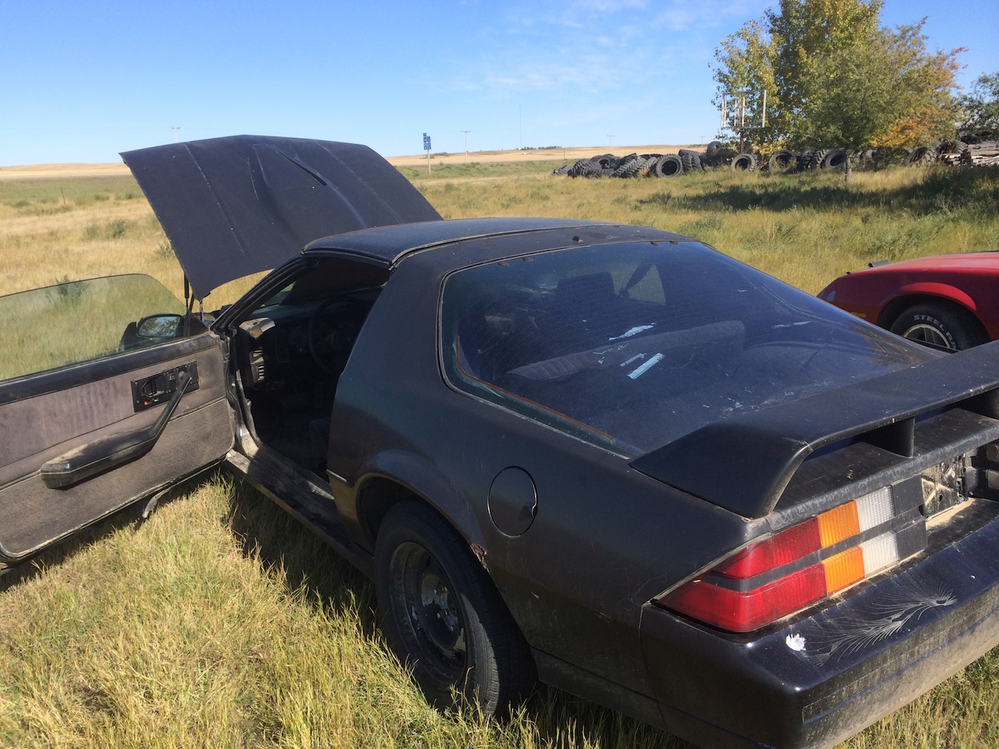

/Users/kwiczak/Desktop/image.jpeg
1,000 dollars

https://www.thirdgen.org/forums/atta...1&d=1380981373

Interesting. Might actually have been done by someone who knew what they were doing. Definitely want to see the underside before final judgement.

I bought the car today. Looks like there are 2 square bars welded along the bottom for extra support
