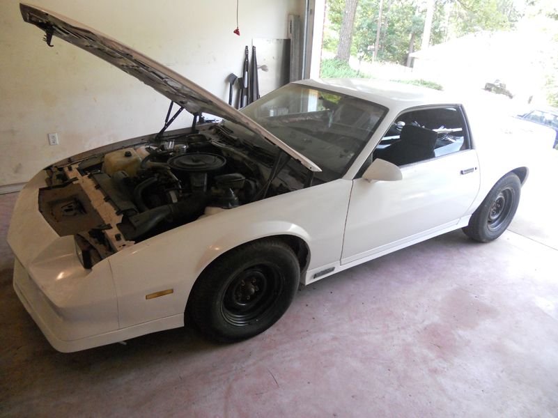

I know it's been a while since I've updated this thread, but it isn't for lack of progress on the car! Although I haven't taken nearly enough pictures, the following post should give a good update.
After the paint cured, it was time to start reassembly. Lights, trim, anything left over that needed to be bolted on got put on, including interior. I didn't take any pictures of the install, really. The wife and I worked together to reupholster the panels with a nice suede material. Everything but the door panels is in at this point.
It seemed to be a one step forward, two steps back battle until about a month ago. Every time I would work on the car, something else would break. I broke the bearings in the steering column, and both the front and back glass. Fortunately, I had a fiberglass hood I traded a buddy for a spare hatch, but the front glass cost me out of pocket.
So, I've always hated the Z28 style grills for the early thirdgen Camaros, plus I hate the price that classic wants for them. I decided to make my own on the cheap. I had some sheet metal leftover from the floor repair, and a buddy who works on a NASCAR team hooked me up with some 1/8 grill mesh (not the cheap home depot crap). I cut out a trim piece just big enough to cover the mounting tabs, and made the mesh fit behind it. The initial idea was to paint it white to match the car, but the nose is warped some, and I couldn't make it fit flush. The gaps really stick out against the white, so I ended up painting them black. I still need to finish mounting the fog lights behind them, but I think they look pretty slick.

So once most of the rest of the car was together, I started driving it around some. Mostly in my neighborhood, to the store, or the two mile drive in to work. This car had some SERIOUS bottom end hiccups. I played with the quadrajet for a while, but I decided to go a different route. I'm not a hardcore "keep everything stock BECAUSE" kind of guy, so it was time for a change. I had a Holley DP sitting in my garage, so I rebuilt it and mounted it up! I also got an MSD streetfire HEI distributor since the stock distributor for my car had no weights or vacuum advance. The car has seriously woken up! As much as an LG4 can, I would assume. Either way, I'm a lot happier now than I was.

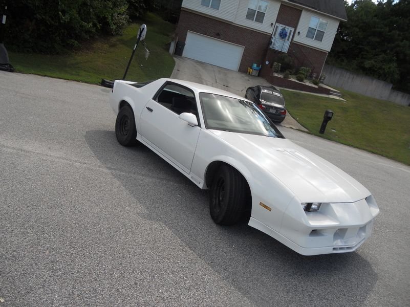

Just for fun, here's a few shots of the car. I honestly think the paint came out good considering what I used and where I did it.

The car came out great. It looks great in white and at its ride height. Did you lower the front at all? I know my car has a much bigger front fender gap than yours does.

Suspension is completely stock! I think turning the wheels is tricking your mind into thinking it's lowered some. Painting the car wasn't bad, just extremely time consuming.
