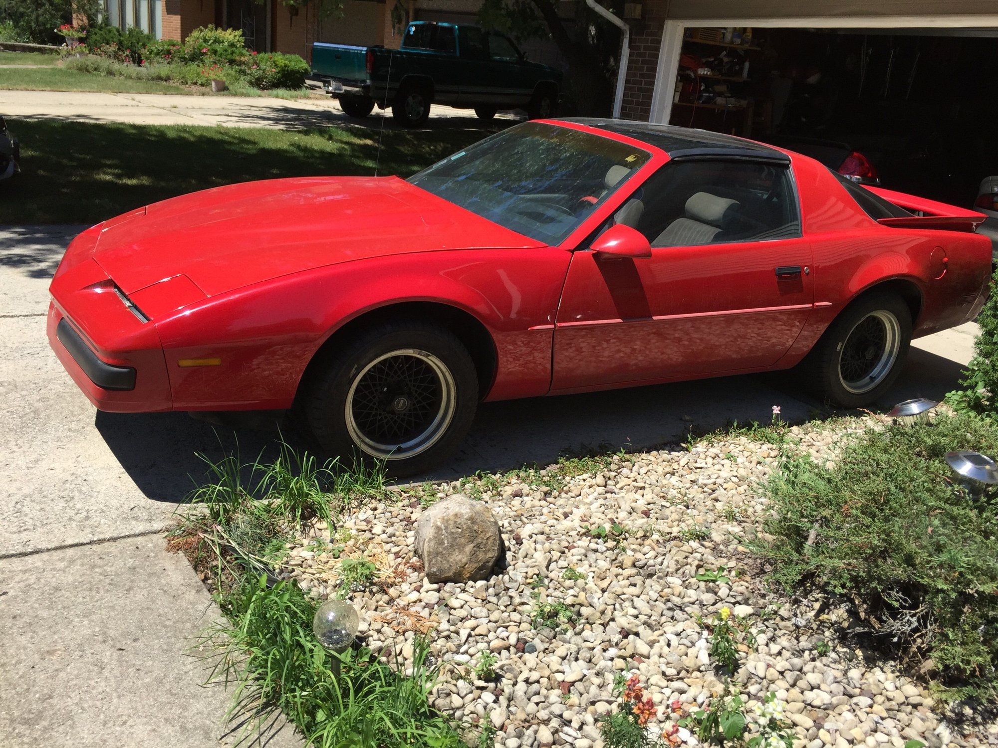

92 Formula 5 speed Restoration Stage 1
For those of which have kept up to date on my posts. I had multiple potential buyers lined up and wanted to buy it, but none of them ever worked out. So I had one that was going to come pick it up. And I realized this feeling I have never felt like depressed, sad, and feeling of like loosing something. I then realized I would highly regret selling it and BOOM. The sentimental attachment kicked in hardcore out of nowhere, and motivated me to start repairing the rust yes. But for me asking 800 bucks temporarily that's practically nothing I have so much time and money invested in this car I would of been taking a huuuuuge loss. And I know I'm trying to save for a house but in the mean time im doing the floors. The house can wait. This is technically my 1st car I ever cared for and the sentimental attachment is to the sky. I cant belive it took nearly selling it for me to realize it after 8 years lol. So I'm putting up pics of the progress here are the floors drivers side has seen better days. lol I cant believe I'm kind of excited about this and motivated. lol you guys have any tips or input feel free to post. I know a lot of you are going to say its not worth it don't do it. Its worth it to me lol. So I guess all I can say is "And so it begins the restoration of Gloria my formula" lol
Attached Thumbnails 92 Formula 5 speed Restoration Stage 1-001.jpg   92 Formula 5 speed Restoration Stage 1-002.jpg   92 Formula 5 speed Restoration Stage 1-003.jpg

Nice job on deciding to keep the car! I haven't been able to drive mine for about a month and a half now because im swapping the L03 for an LT1 but it has absolutely sucked! How much rust is there that you need to fix?
Well im sure more will reveal itself but the floors,wheel wells and quarters. I just took the interior out and im ordering the floors. It will be under the covers for a while hoping to have the floors and quarters and wheel wells done before winter.This will be the first winter it wont be stored outside. It will be in a climate controlled place if my friends dad hasn't filled it up already lol. But i will say one thing it would be really nice to have a plasma cutter right about now, so I don't have to go through so many cutoff wheels lol.
