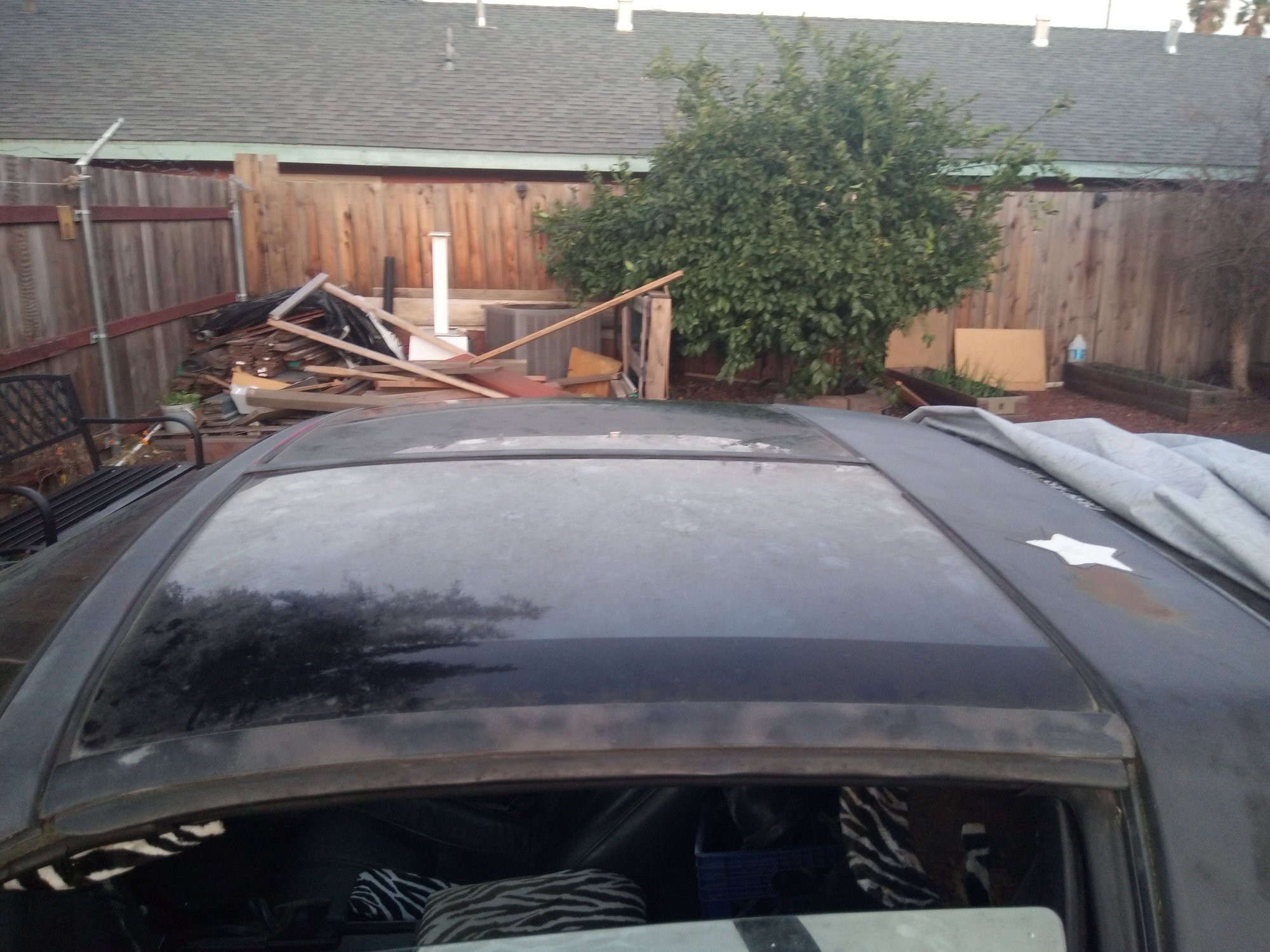

Old Mar 3, 2020 | 01:44 AM

Re: What's a c&c t top?
Originally Posted by UNCLE TOM
c&c t tops were an after market conversion . factory t tops came in (as far as I know) 3 different types . 1. hook type latches , 2. small pin type latches , 3. larger pin type latches . you with an 83 may have the hook type latches . I may have a set with hook latches . PM me if interested and I will dig into my pile . good luck .
Can you tell by the picture what kind if t tops these are?
Old Mar 3, 2020 | 02:18 AM
lonsal's Avatar
Joined: Dec 1999
Posts: 5,964
Likes: 37
From: Hacienda Heights, CA
Axle/Gears: 3.45, 3.27, 3.27
You have a factory T-top, not an aftermarket C&C t-top.

Old Mar 3, 2020 | 01:16 PM
Thirdgen89GTA's Avatar
Joined: Sep 2004
Posts: 5,906
Likes: 240
From: Chicagoland Suburbs
Car: 1989 Trans Am GTA
Transmission: M28 T56
That and the glass on C&C T-tops is etched with the C&C logo if I remember. Will need to take a picture of mine.
