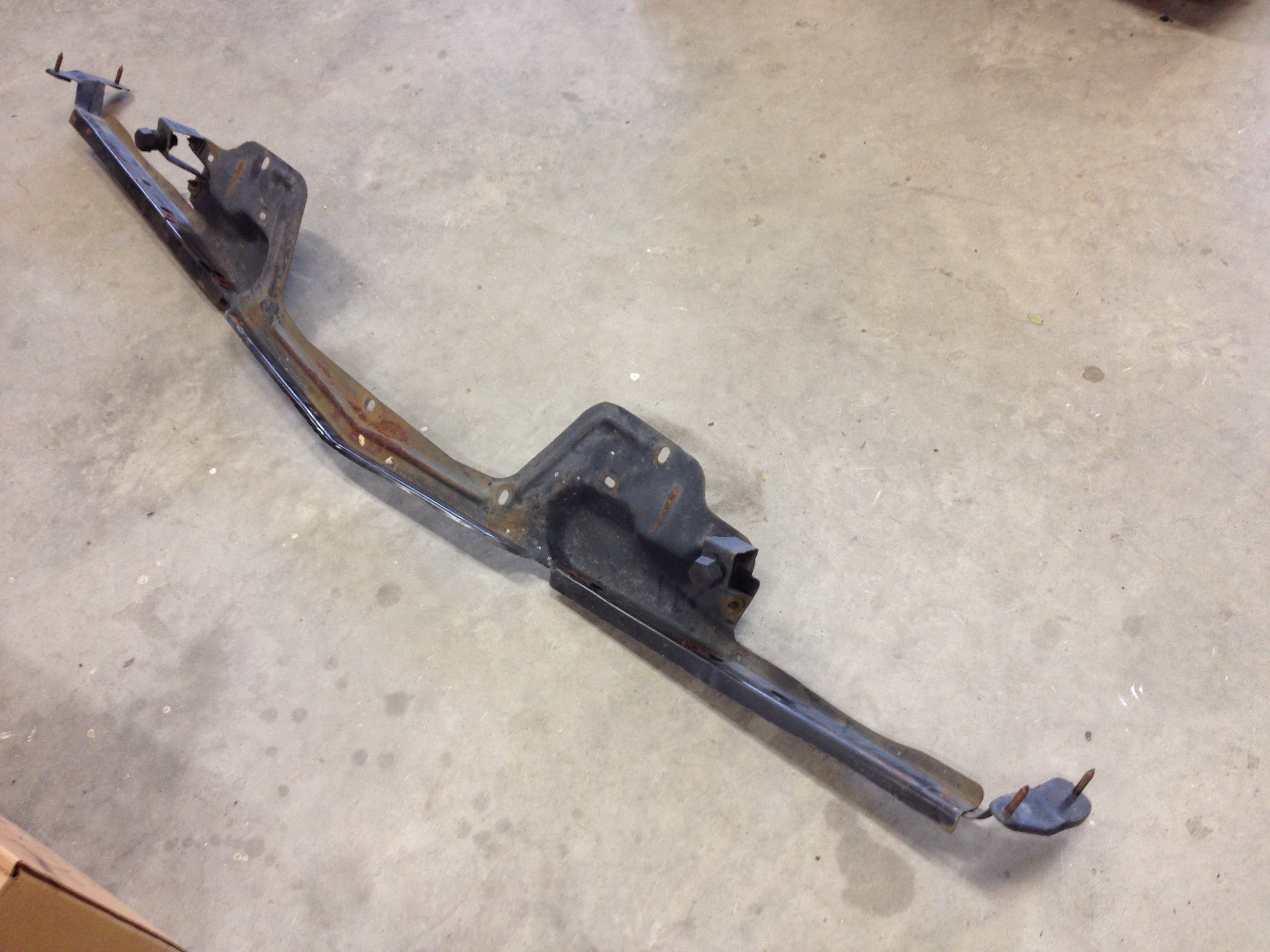

It is attached to the fenders using a metal support bar with studs. These are usually pretty rusty by now. The nuts are inside the fenders at the upper forward edge. 10mm I think but could be anything if it was removed before. The top edge is held on with 7mm bolts at the hood latch plate. Belly pans have to be removed before. Should be a pic from the service manual on the forum here somewhere.

No the metal bar isn't visible, it runs across the bumper cover above the green line in the first shot. Here's a pic of one. Part of it is visible next to the turn signals.
If I remember correctly the Trans ams also have a metal retaining bracket below the support bar to connect the fender ground effects to the lower part of the nose cone. I've got some more tear down pics on my other computer I can post on Tuesday.
