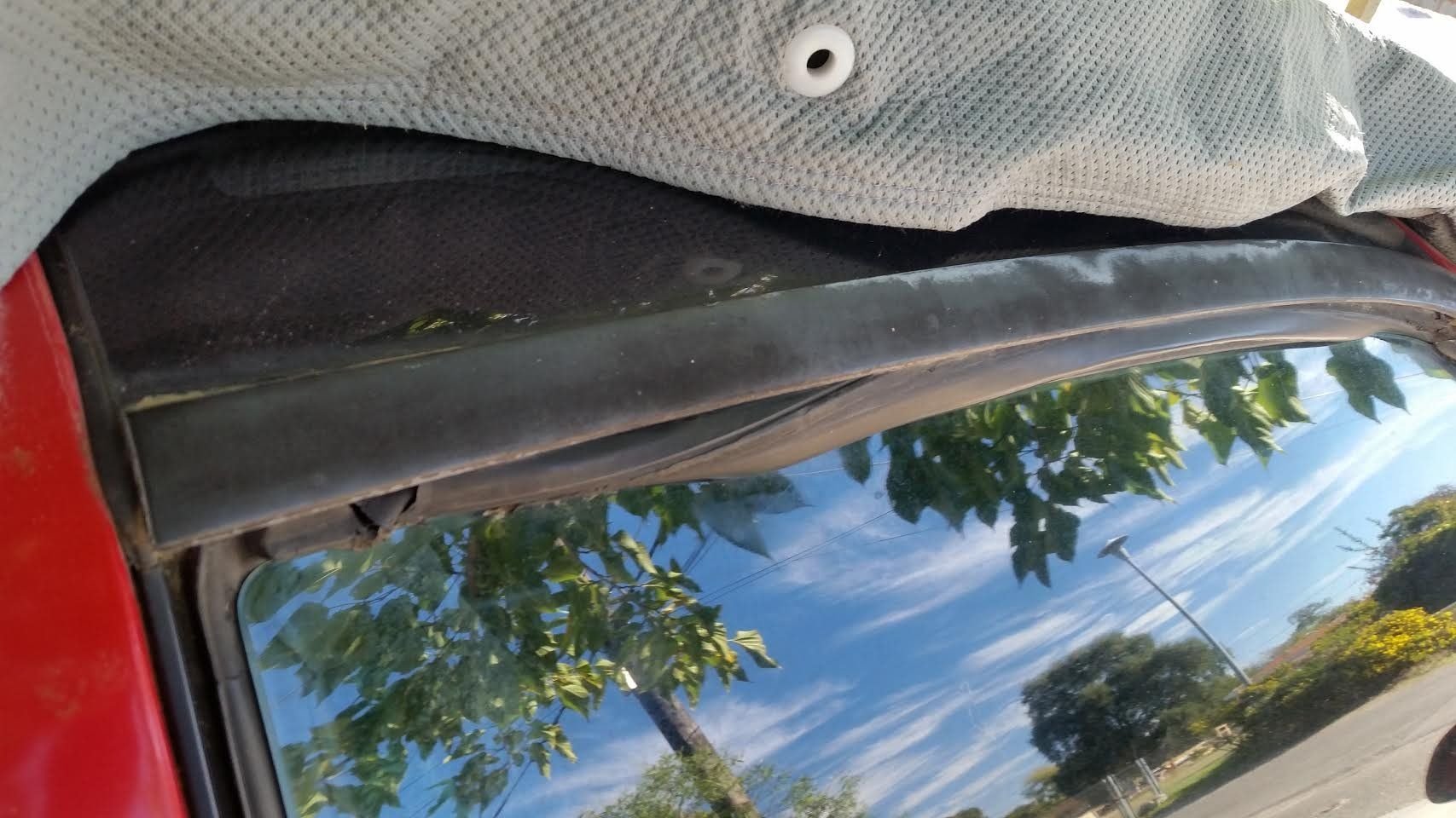

Can anyone tell from my pictures what I need to replace?
The passenger side is obviously bad, but the driver side looks fine to me. Yet, both sides leak, so I am confused.
I'm on a tight budget at the moment, I have about $50 to spend.
I'm looking at these (hoping I only need 1 of them)
https://www.1aauto.com/1982-92-chevy...=301039&y=1989
https://www.1aauto.com/1982-92-chevy...=367216&y=1989

Buy one side at a time, definitely need the Right side(drip edge and weatherstrip)

I haven't seen anywhere selling 1 side for a reasonable price (correct me if I'm wrong)
Is this part that I circled the drip edge, and the rubber part below that the weatherstrip?
https://i.imgur.com/cs58MTw.jpg

Drip edge is whats needed. Ttop weatherstrip can be done late. I got mine at hawks. A 100 bucks for both or near there. Shop around contact the manufacturers. Replace the worse and go from there
