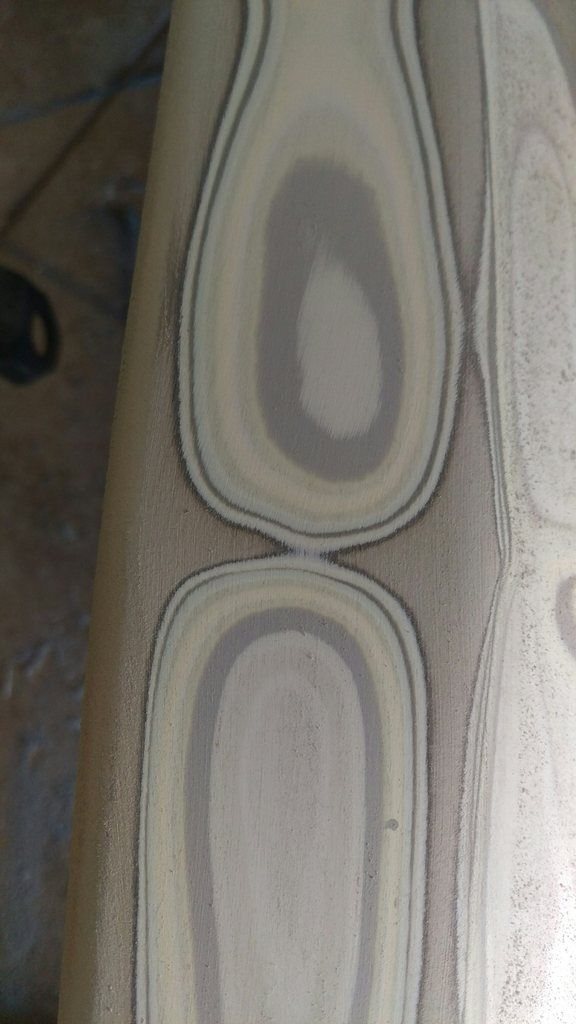

These cars are too old to do a blind scuff and squirt. If you really wanted to do a scuff and squirt you need to sand one small spot (dime sized) on each panel down to the base. That means sand a spot on the front and rear bumper, both front fenders, both doors, the hood and the pick a rear quarter panel. Why? because you have no idea how many times the part has been painted. Take my latest project for example, after sanding a spot down on the front bumper I knew I had to take the car to base. You can count the number of times the car has been painted, 5?!
Yes, you could probably make the argument that bumpers get repainted most. My bumper did have the most paint on it then came the driver's side fender and door that had three coats and the rest of the car that had two coats on it. Maybe you just think that its just luck. The rear spoiler that I bought had separately on eBay had at least 5 if not 6 coats of paint!
You have been warned.
