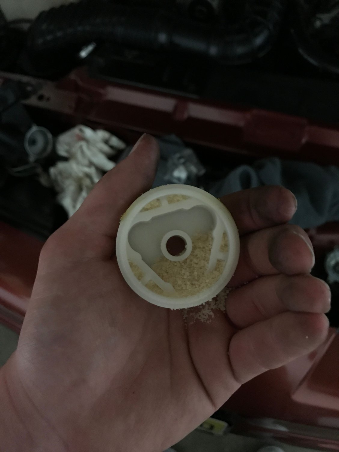

Been there done that.. its the bushings inside the gears, they fall apart after so long thats what it will most likely look like when taken apart

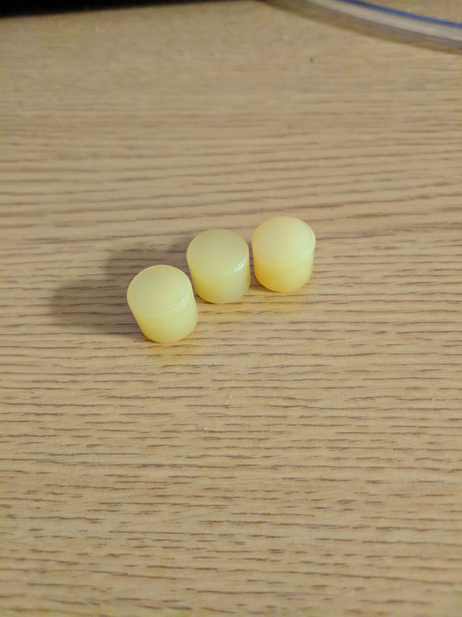

Do the new ones look like this? and i have to open the headlight motor to replace them right?

You are correct.

Thank God. The guy I bought the car handed me two packs and said I might need them but didn't explain what they were for. I literally started having headlight issues a few days ago.

Do you know where I could get more of these bushings?

Re: Headlights not popping up
Top down solutions sells a kit for it.
