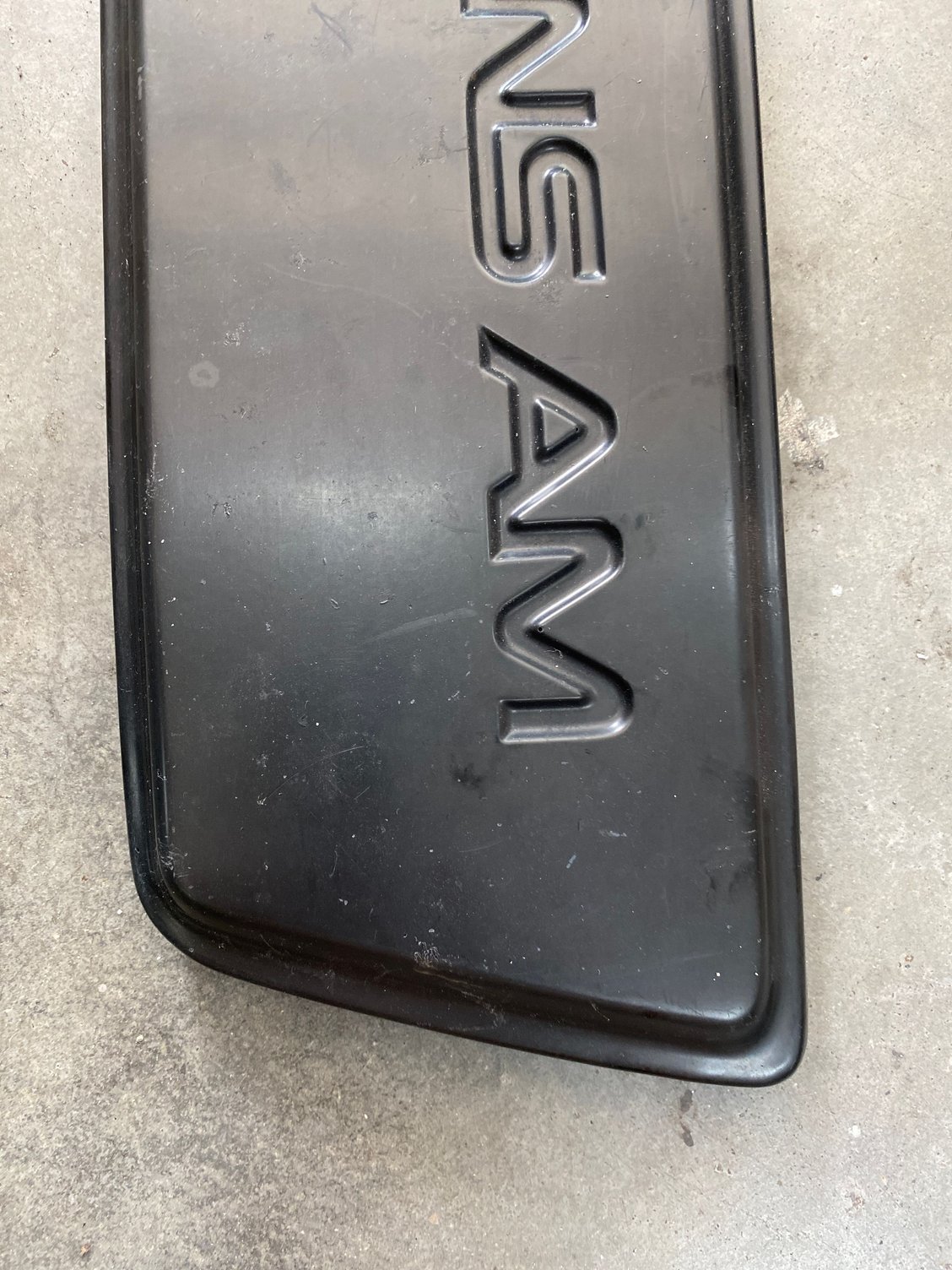

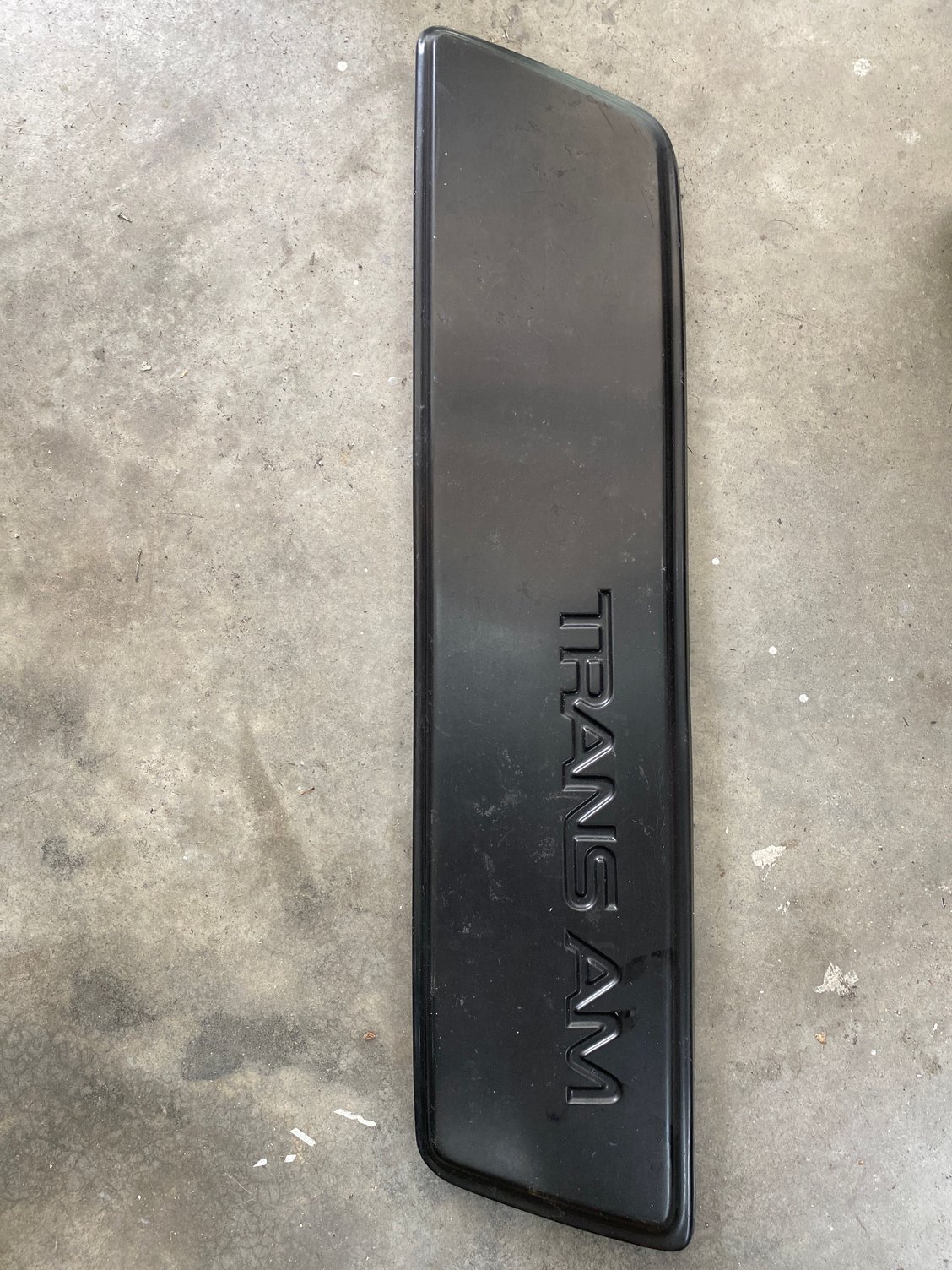

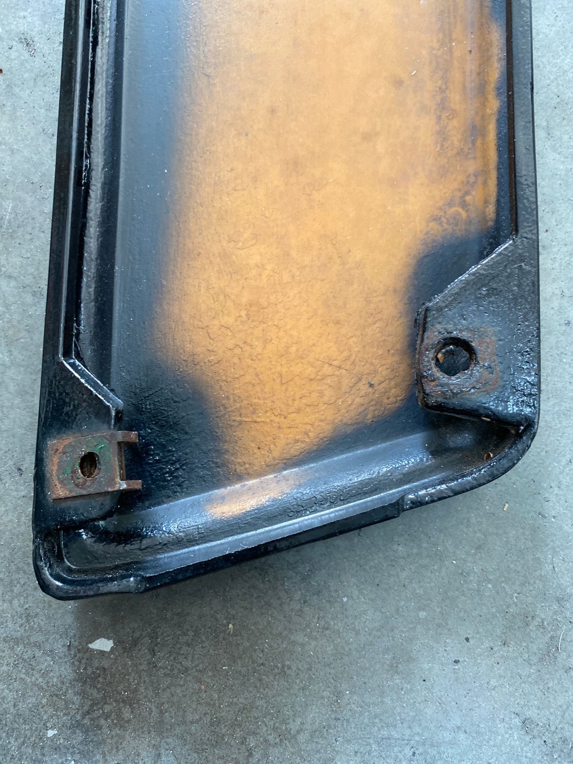

I’m in the middle of restoring my 84 TA right now. The factory inserts appear to be the same material as the clip. They appear to have been painted gloss black(see back photo), but the gloss on the front appears to have worn off.
Back
Back, close up
Front
Front close up

Yes, the grills on the 1984 Trans Am with the Aero Package were all painted Gloss Black with the exception of the 15TH Anniversary which were painted white.
