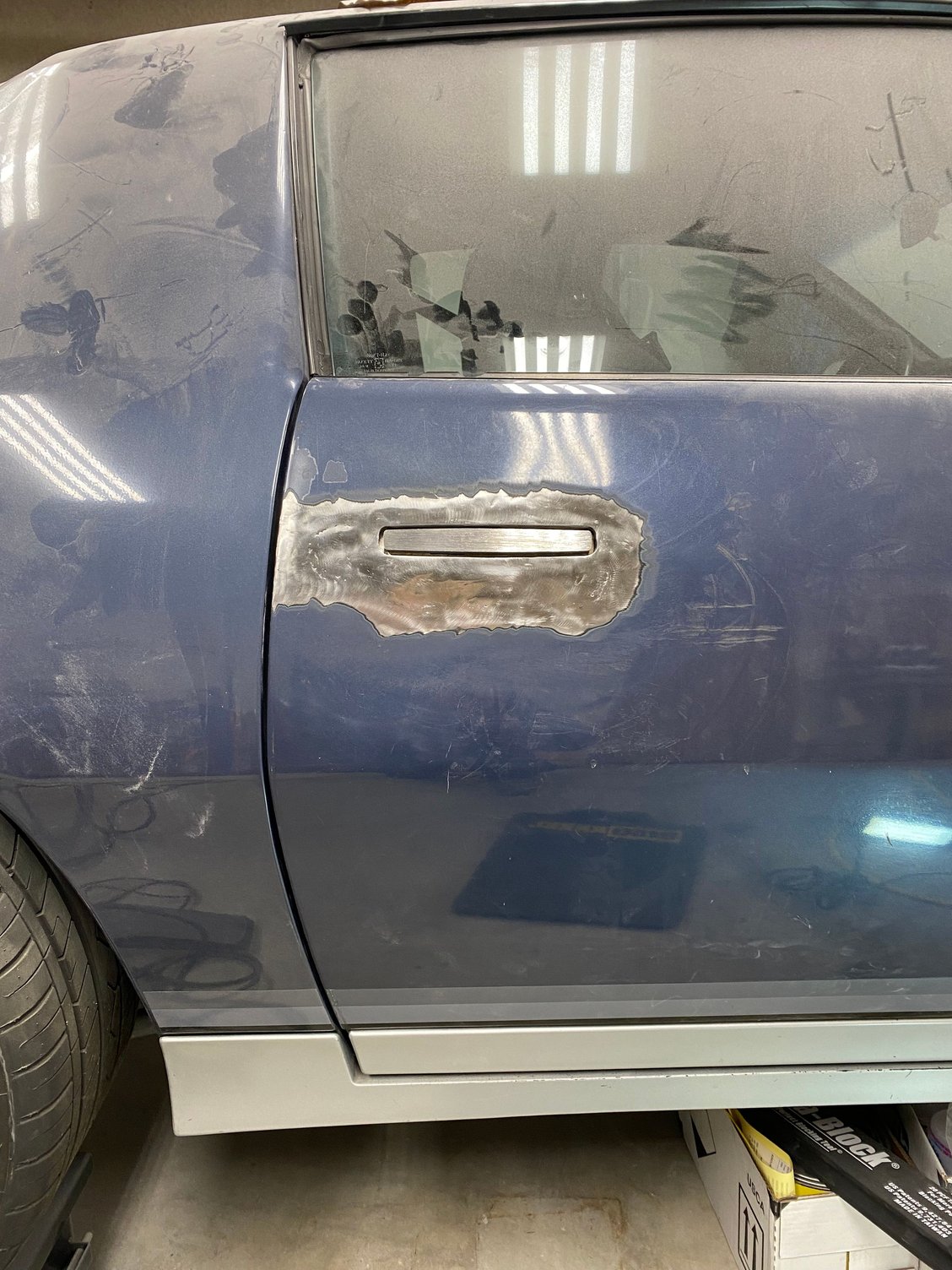

Anyone running shaved door locks?

If so where did you put an unlock switch and how did you do it.

The car has power locks with a remote fab. In the event that I lose power, the key lock is still behind the license plate and the battery is in the rear compartment under the floor hatch. I’m not sure how often I will lock this car since I will not be leaving it unattended, but they work just in case I do.
what remote fob are you using, if I decide to do that i want to know a good one

I’m using the Dakota Digital unit for the simplicity, it tied directly into the power lock solenoids at the kick panel and I also tapped into the trigger wire for the rear hatch release since it passes through that area.
