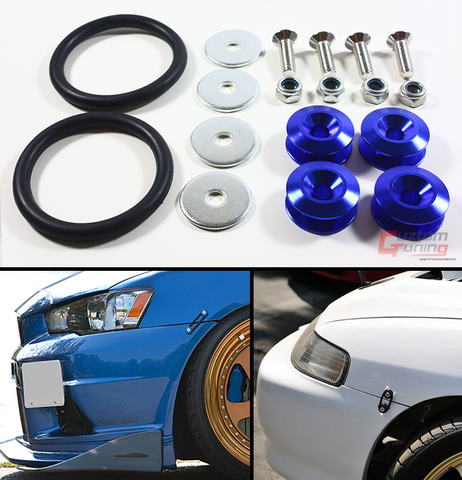

I'm sort of trying to deal with a whole lot of things at once, which got me looking at my old threads and karr, your response lit up a lightbulb: The biggest PITA on the 'bird front covers are the plates/studs that stick through the nose and the nuts that tighten them down... What if I used the studs as alignment pins and used something like the import guys do to pull the 2 together. Doing a quick search I came up with these ideas:
