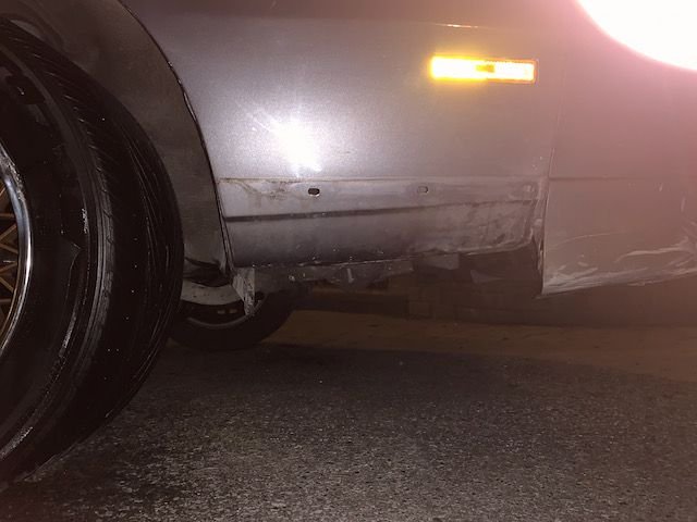

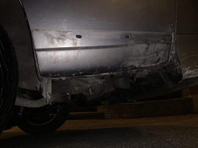

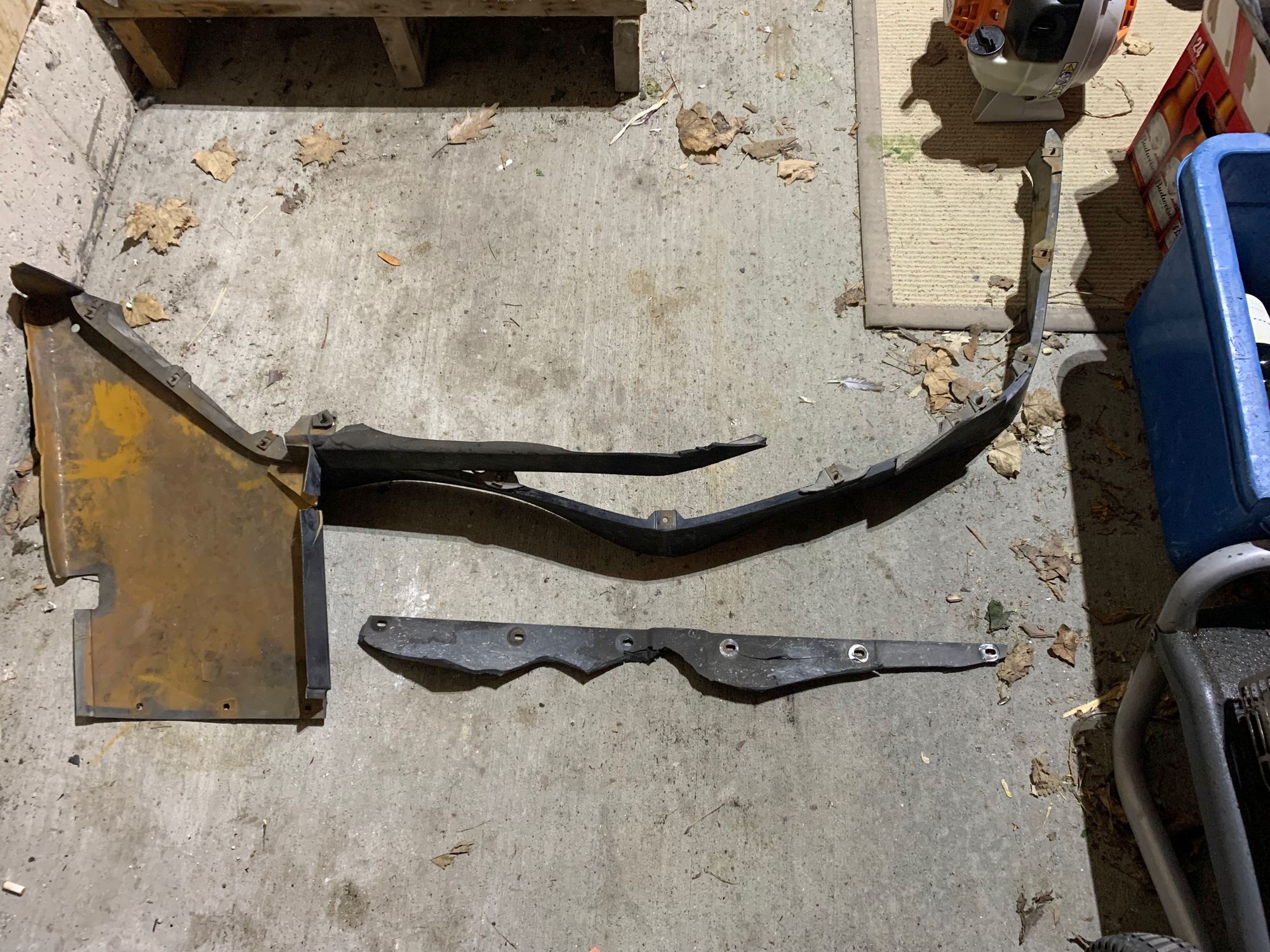

My issue is that I cannot find evidence of this plastic bit (10017670) existing, no pictures to cross reference between good condition ones and my broken one, etc... All I want to do is to fix my air dam so that the engine does not overheat, and to replace the visual front fender ground effects. Any help is appreciated! Thanks
Air dam (good I think) + one of the broken ground effects + plastic bit that needs replacing (10017670)? Can't find this bit anywhere
Both sides look like this
Close up of underbody;

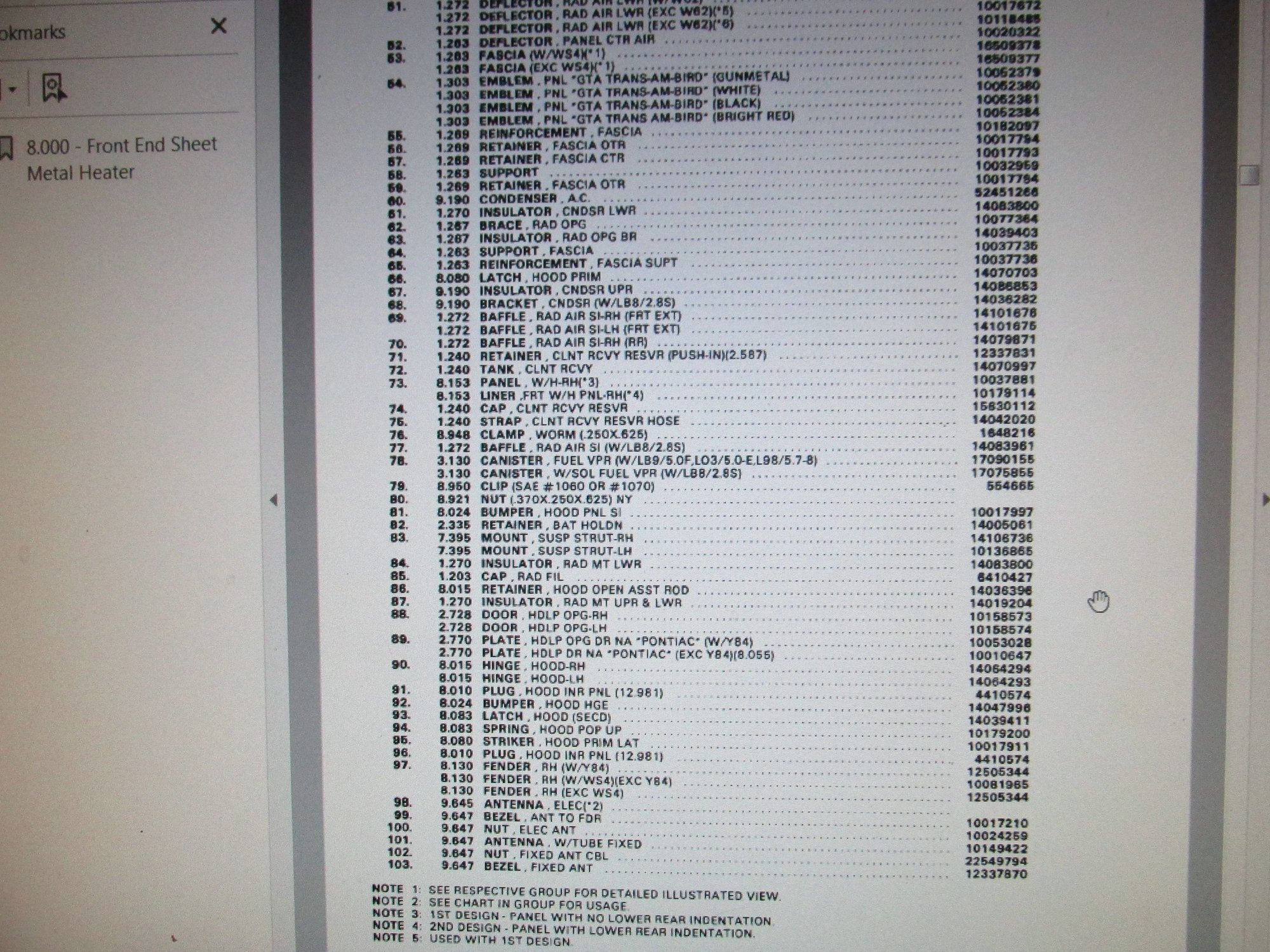

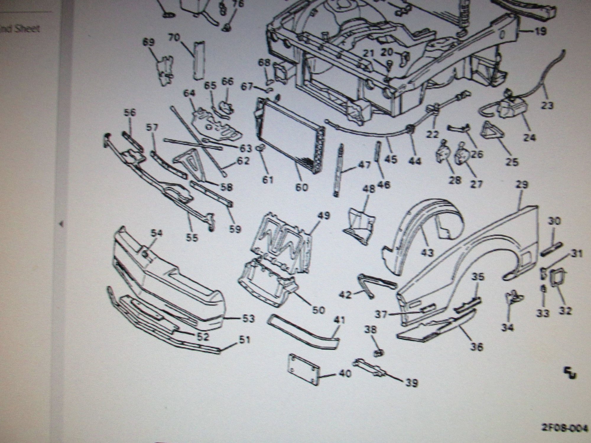

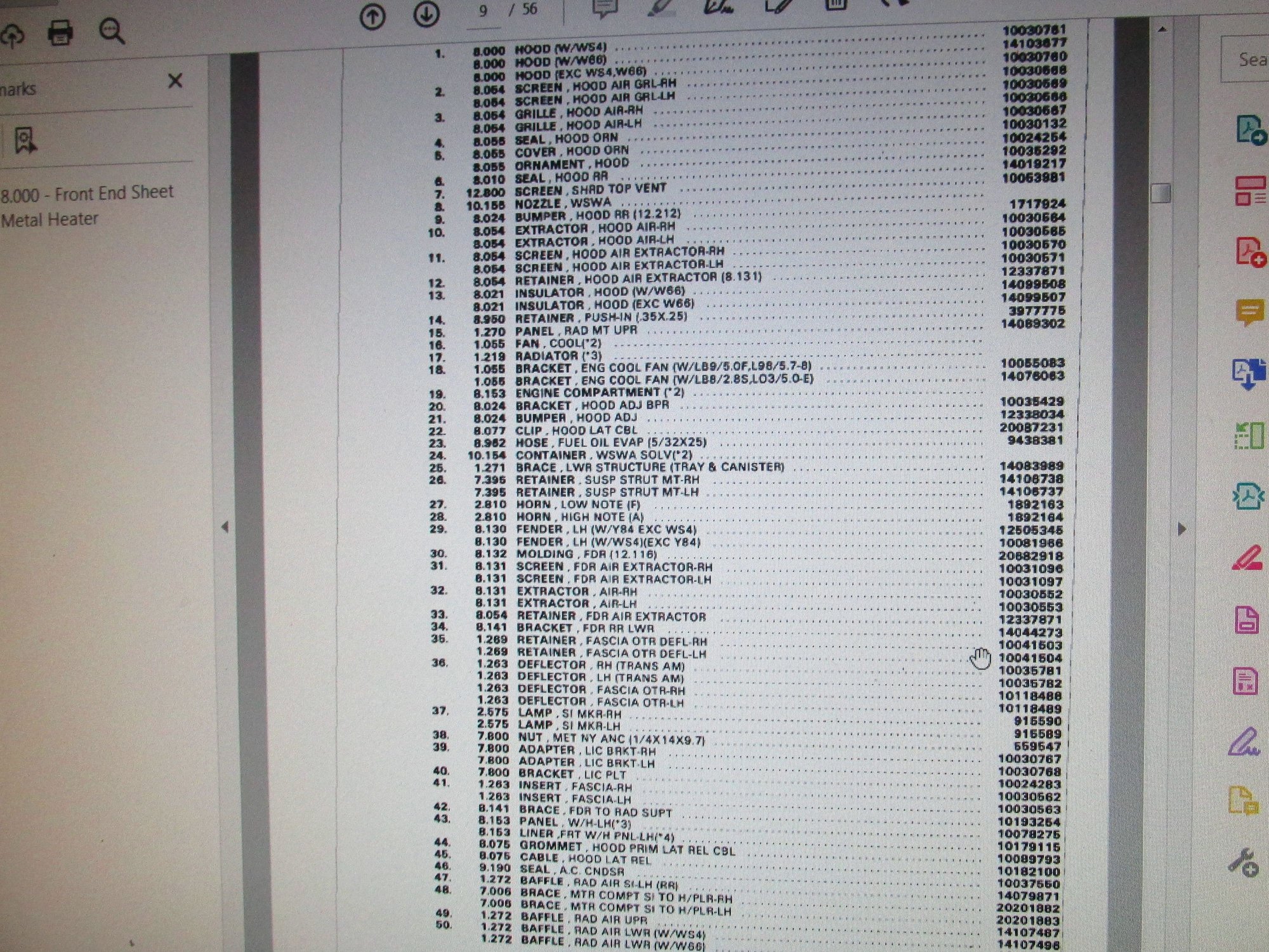

I just seen your post sorry took so long to reply,maybe these pics will help.
no 51 P/N is 1018484
