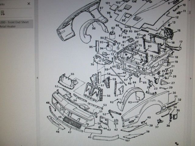

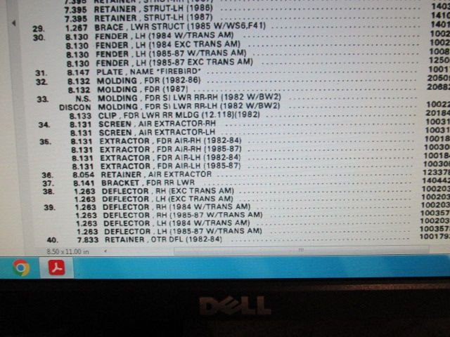

Old Jul 24, 2022 | 04:14 PM
mantaguy's Avatar
Joined: Nov 2010
Posts: 5,892
Likes: 85
From: Mantua NJ
Engine: 5.0 EFI
Transmission: THM700R4
Axle/Gears: 277 Posi Speedo
Re: Buying a 1986 Trans Am and have a question about the ground effects
The parts book only list that part for the TA,the GTA uses the same part no. from 82 -90 uses the same part
Thanks for confirming this!
