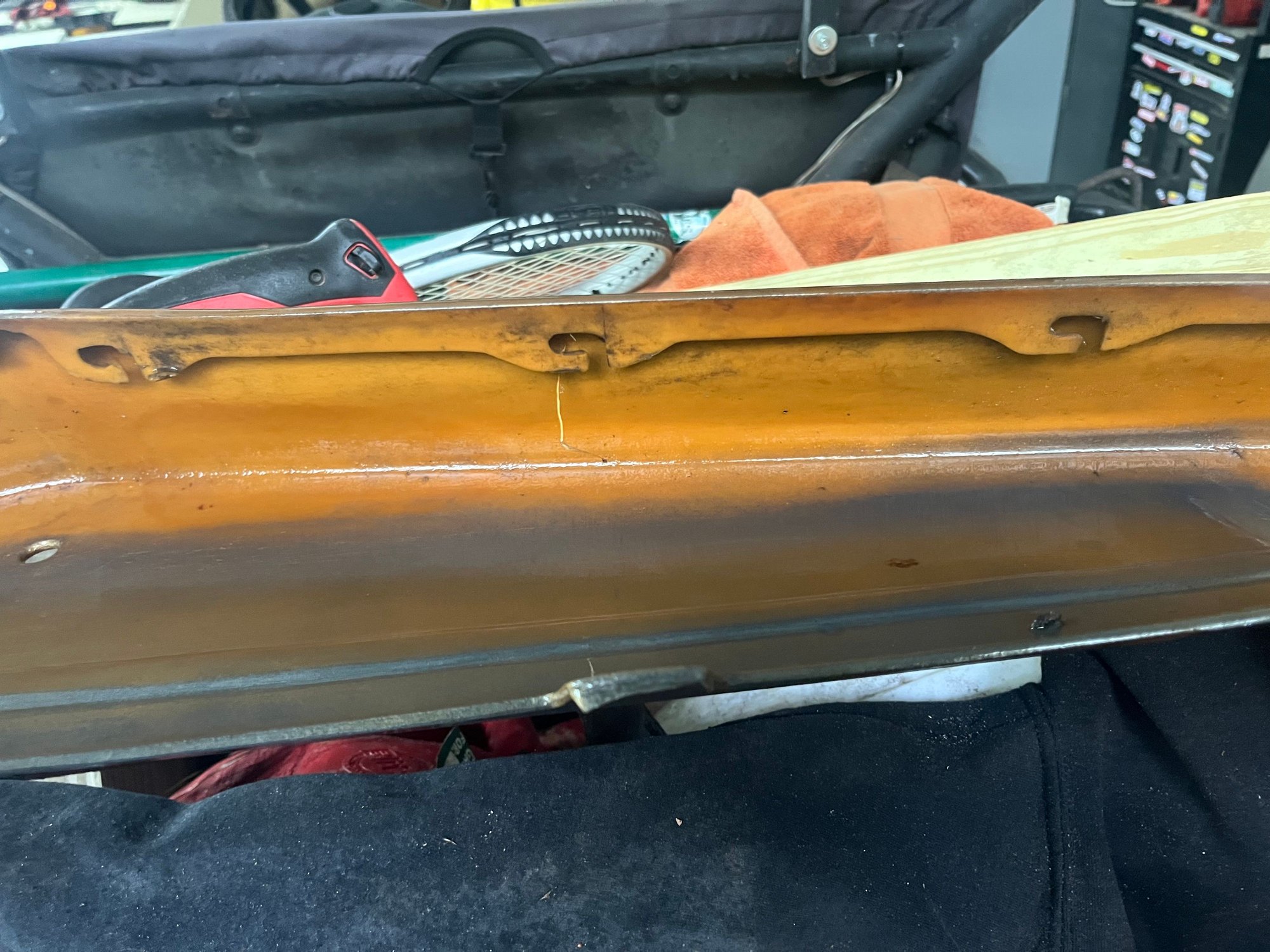

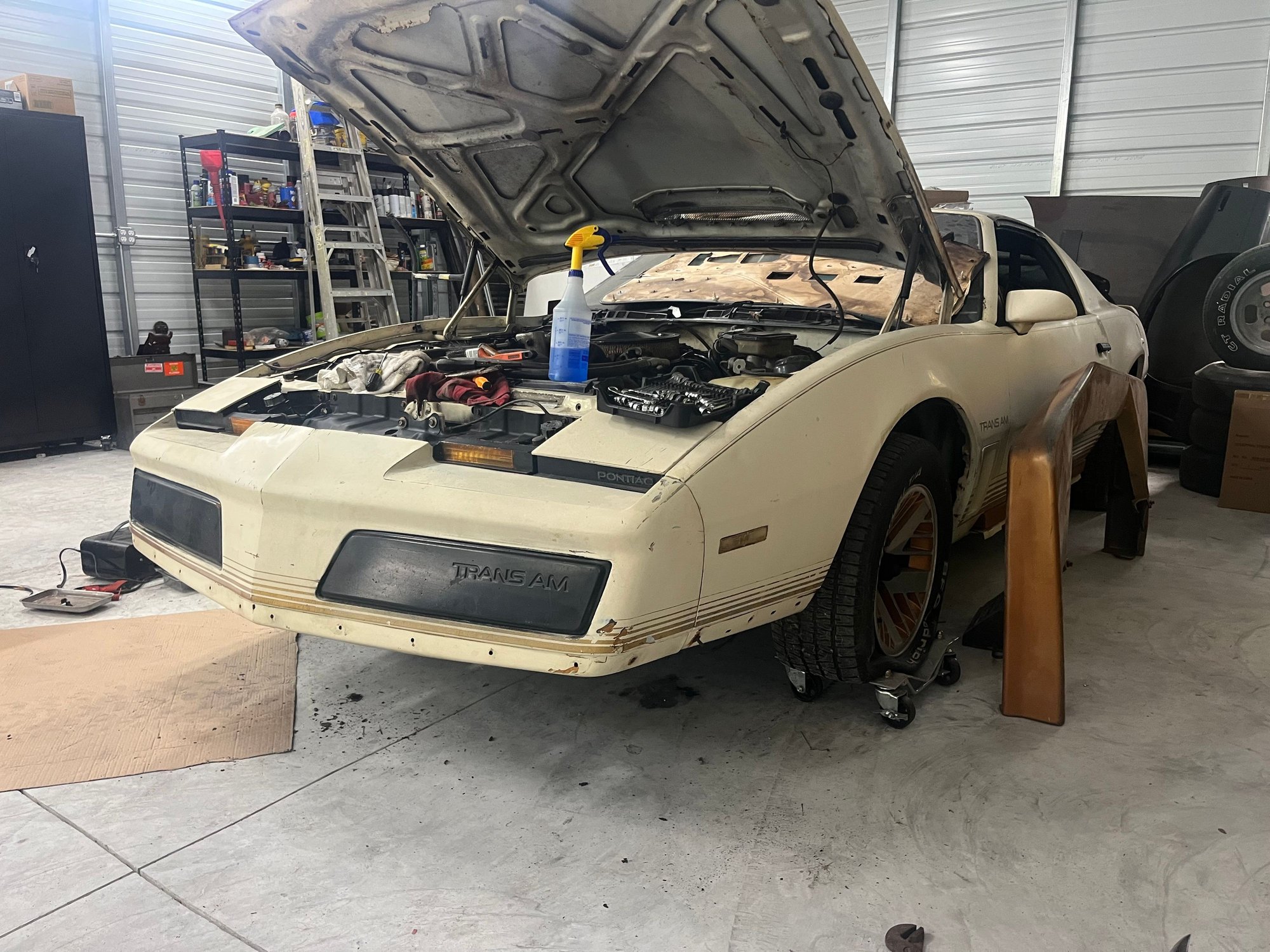

Quick question, I think my car is a 84. How do I attach the lower ground effects on the front bumper? The ground effects have some kind of slide in fastener but I have no clue how to attach.

They install with flat steel mounting brackets that have threaded studs on them. When I restored my car we made new ones cause the originals were shot.
I posted some pictures in my build thread here:
https://www.thirdgen.org/forums/memb...ml#post5891099

Great info. I made some from 2 strips of aluminum, worked great. Thanks for the reply!
