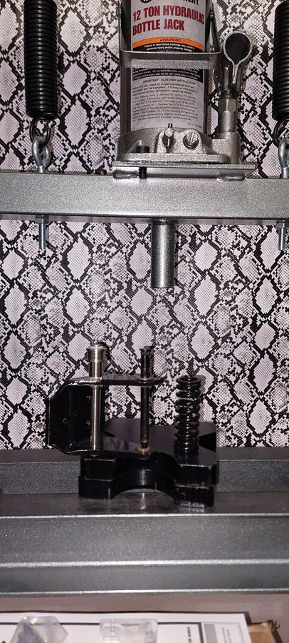

if your hinges are original, then you will not be able to push the new detent pin in the existing hinge. you will be installing the new hinge pin then the roller and roller pin. i had to use a press to get them installed.
