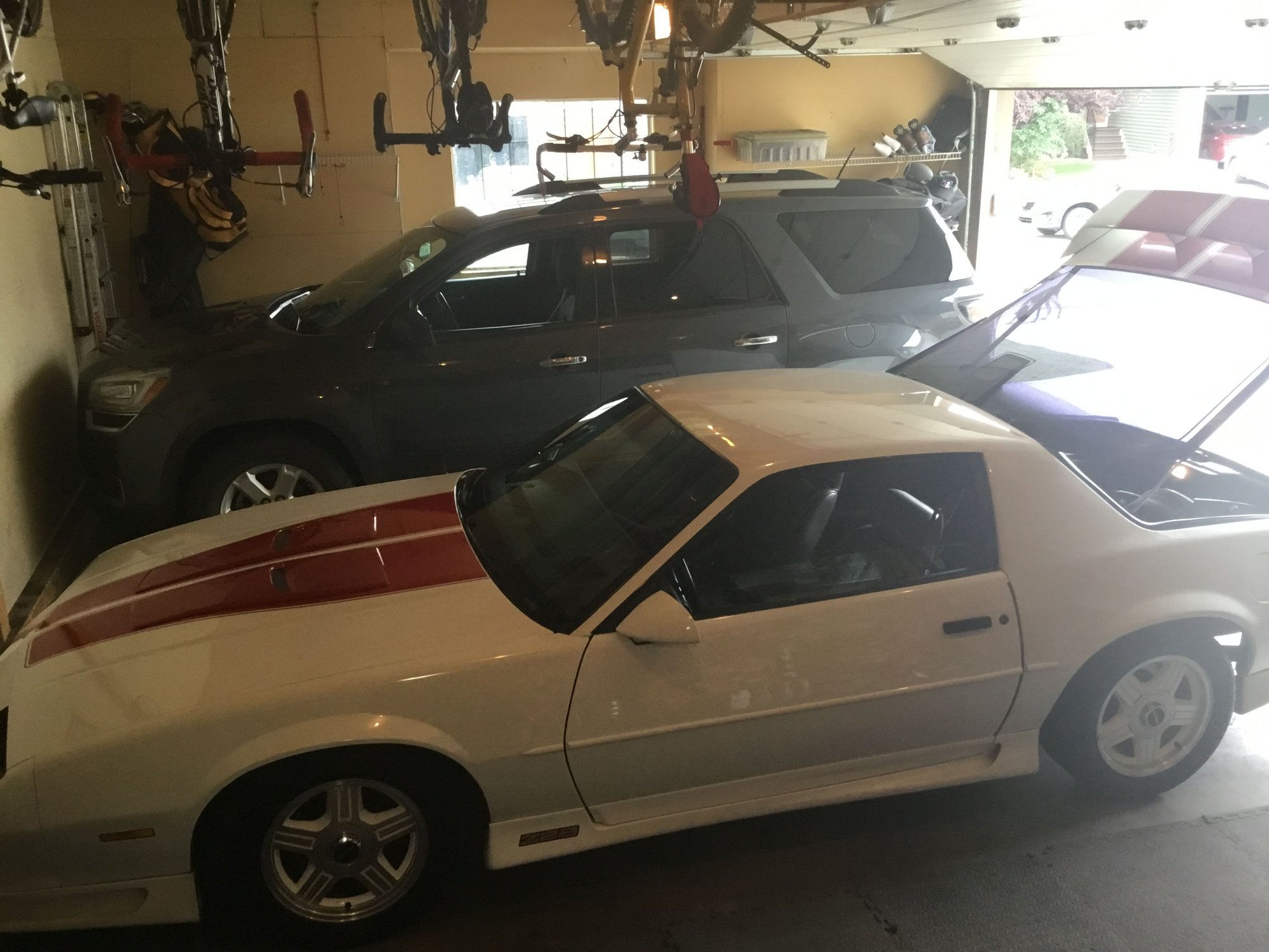

I just came home with a 1992 Z28 anniversary car. Needs some TLC and sorry for the bad pic but thought I would snap a quick one.

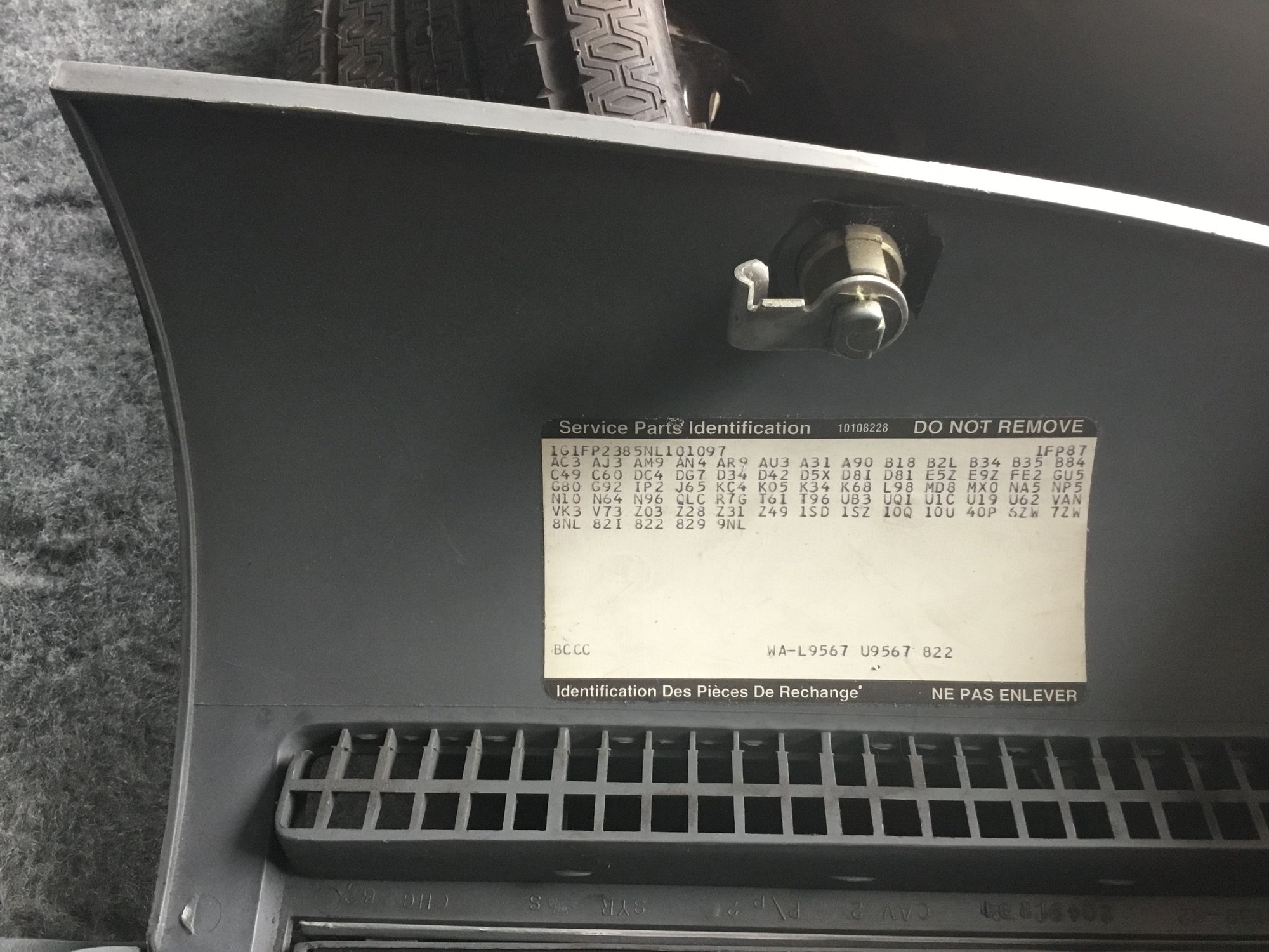

I would like some opinions and feed back on my option list sticker that I attached to find out if there are desirable options here. It has 4 wheel disc but not sure if that was factory or not on this car. It does have an L98 that is built up with roller cam and rockers and such and ceramic coated headers, otherwise it is fairly stock. If someone would not mind decoding some of my options and share an opinion good or bad that would be most appreciated.

Welcome from London, ON!
Looks like a nicely equipped Canadian ride!
AC3 WINDOW "SLIDING FRT DR, LH" Window EDIT: I think this should be "AC3 6 way power seat"
AJ3 RESTRAINT SYSTEM "SEAT, INFLATABLE, DRIVER" Driver Air Bag Module
AM9 SEAT RR "SPLIT BACK, FOLDING" Second Row Seats
AN4 RESTRAINT PROVISIONS CHILD Front Outboard Safety Belts
AR9 SEAT "FRT BKT, DELUXE" Front Seats
AU3 LOCK CONTROL "SIDE DR, ELEC" Locking
A31 WINDOW "POWER OPERATED, ALL DOORS" Body Closures
A90 LOCK CONTROL RR CMPT "LID, REM CONT ELEC RELEASE" Vehicle Access
B18 ORNAMENTATION "INTR, DELUXE" Interior Trim
B2L PERFORMANCE PACKAGE "ENGINE PACKAGE V8, 5.7L. PFI" Engine
B34 COVERING FRT "FLOOR MATS, CARPETED INSERT" Floor Mats
B35 COVERING REAR "FLOOR MATS, CARPETED INSERT" Floor Mats
B84 MOLDING B/S EXTERIOR Body Side Molding (< 200mm Tail)
C49 DEFOGGER "RR WINDOW, ELECTRIC" Rear Interior HVAC Airflow
C60 HVAC SYSTEM "AIR CONDITIONER FRT, MAN CONTROLS" Front Interior Control
DC4 MIRROR I/S R/V "TILT, DUAL READING LAMPS" Inside Rearview Mirrors
DG7 MIRROR O/S "LH & RH, REMOTE CONTROL, ELECTRIC, COLOR" Outside Rearview Mirrors
D34 MIRROR I/S FRT VAN "LH & RH, SUNSHADE, NO ILLUMINATION" Sunshade System
D42 SHADE RR COMPT Convenience Net
D5X GEAR SPEEDO DRIVEN (D5X) Clusters
D8I SENSOR VEH SPD (D8I) Vehicle Speed Sensor
D81 SPOILER "RR, AERO WING" Spoiler
E5Z SPEEDOMETER ADAPTER (DELETE) 0 0
E9Z SPEEDOMETER KEY (DELETE) 0 0
FE2 SUSPENSION SYSTEM "RIDE, HANDLING" Suspension
GU5 AXLE REAR 3.23 RATIO Rear Driven Axle & Differential Carrier
G80 AXLE POSITRACTION LIMITED SLIP Rear Driven Axle & Differential Carrier
G92 AXLE REAR RATIO PERFORMANCE Rear Driven Axle & Differential Carrier
IP2 TRIM INTERIOR DESIGN (P2) Interior
J65 BRAKE SYSTEM "PWR, FRT & RR DISC" Brake
KC4 COOLING SYSTEM ENG OIL Oil
K34 CRUISE CONTROL "AUTOMATIC, ELECTRONIC" Throttle Apply
K68 GENERATOR 105 AMP Generator
L98 5.7 LITER V8 TPI ENGINE 0 0
MD8 "TRANSMISSION, AUTO 4 SPD, THM 700 R4" 0 0
NA5 EMISSION SYSTEM "FEDERAL, TIER 0" Powertrain Integration
NP5 STEERING WHEEL LEATHER WRAPPED Steering Wheel
N10 EXHAUST SYSTEM DUAL Exhaust
N64 TIRE & WHEEL "SPARE, SPACE SAVER, ALUMINUM" Tire/Wheel/Trim
N96 WHEEL "16 X 8, ALUMINUM CAST" Road Wheel
QLC TIRE ALL P245/50ZR16/N BL R/PE ST TL HW4 Road Tire
R7G CONTROL SALES ITEM NO. 32 Vehicle
T61 LAMP SYSTEM DAYTIME RUNNING Headlamps
T96 LAMP "FOG, FRT" Front Fog Lamp
UB3 CLUSTER "INST, OIL, COOL TEMP, VOLTS, TRIP ODOM, TACH" Clusters
UQ1 RADIO "PROVISIONS, AM/FM STEREO" Radio Head
U1C RADIO "AM/FM STEREO, SEEK/SCAN, CD, CLOCK, ETR" Radio Head
U19 SPEEDOMETER "INST, KILO & MILES, KILO ODOMETER" Clusters
U62 SPEAKER SYSTEM "4, DUAL COAX FRT, DUAL COAX PKG SHELF" Speaker
VAN PLANT CODE "VAN NUYS, CA, USA" Vehicle
VK3 LICENSE PLATE FRONT FRT MOUNTING PKG License Plate Attachment
V73 VEHICLE STATEMENT USA/CANADA Vehicle
Z03 APPEARANCE PACKAGE ANNIVERSARY Vehicle
Z28 MERCHANDISED PKG SPECIAL PERFORMANCE Vehicle
Z31 IDENTIFICATION PRICE SHEET ADVANCE Vehicle
Z49 EXPORT CANADIAN MODIF MANDATORY BASE EQUIP Vehicle
1SD PACKAGE OPTION 04 Vehicle
1SZ DISCOUNT OPTION PACKAGE Vehicle
10Q MOLDING COLOR ARCTIC WHITE (91) Exterior
1OU PRIMARY COLOR "EXTERIOR, PARCHMENT SILVER MICA" Applied Coatings
40P WHEEL COLOR WHITE (91) Wheel
6ZW COMPONENT FRT LH COMPUTER SEL SUSP (6ZW) Front Suspension
7ZW COMPONENT FRT RH COMPUTER SEL SUSP (7ZW) Front Suspension
8NL COMPONENT RR LH COMPUTER SEL SUSP (8NL) Rear Suspension
82I INTERIOR TRIM MED DK GRAY (91) Interior Trim
822 Leather Interior Trim package - NOT VERIFIED 822 (Medium Dark Gray) #N/A
829 "SEAT BELT COLOR, MED DK GRAY (91)" 0 0
9NL COMPONENT RR RH COMPUTER SEL SUSP (9NL) Rear Suspension
This is what I have. If something on the list seems wrong, it may well be. I have gathered a lot of codes over time and sometimes GM reuses them years later.
822 wasn't in my list at all so it may be suspect.

Well thank you sir for taking time out of your day to help me decode the car. Much appreciated!
Going to work on it over the winter to touch some things up.
the 822 code you checked is correct. It does have grey leather. The leather is not in great condition though unfortunately - I wish I could find a supplier that made new leather covers for the front and back seats......................... to keep original. I might have to switch it to cloth.

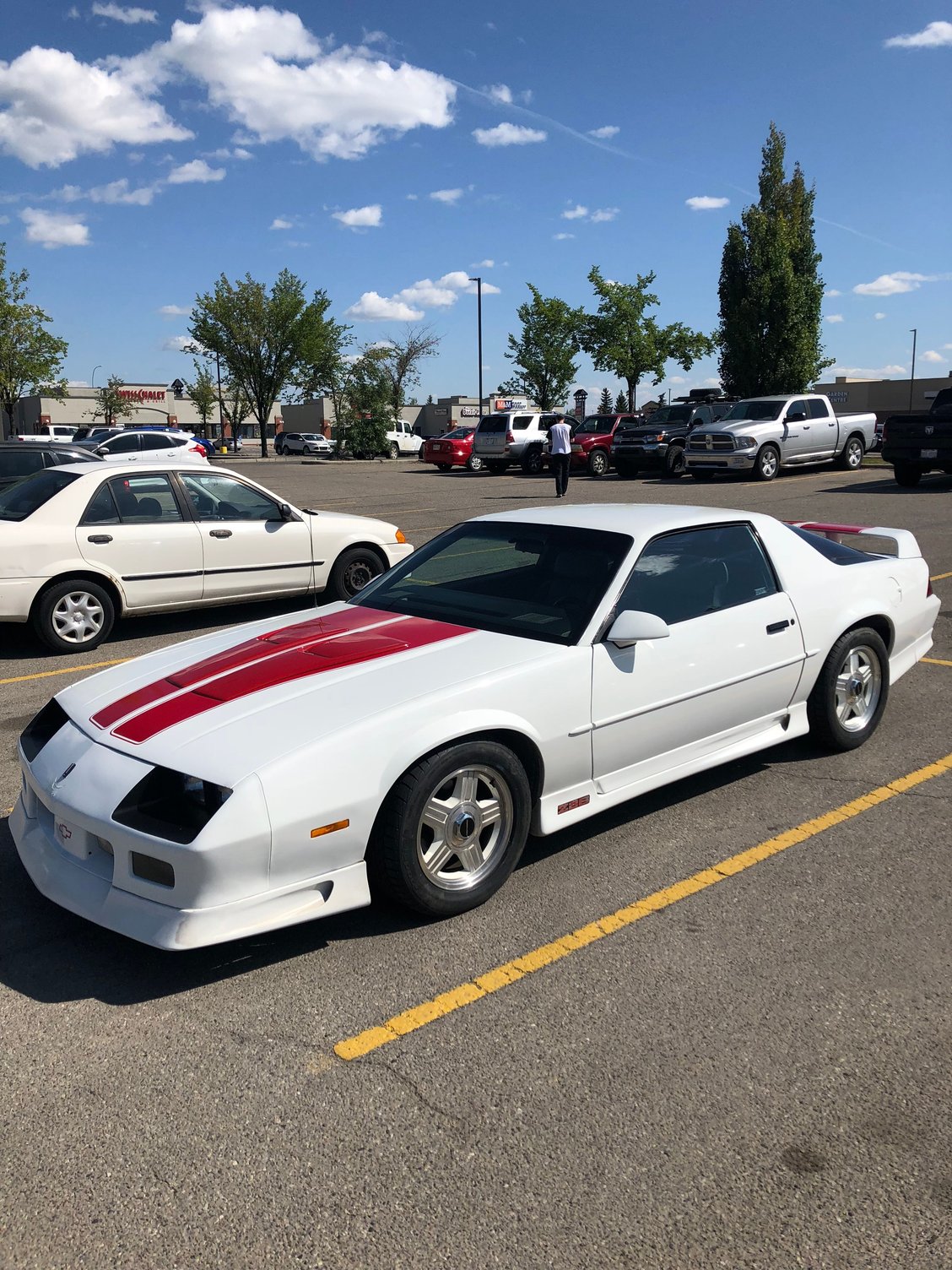

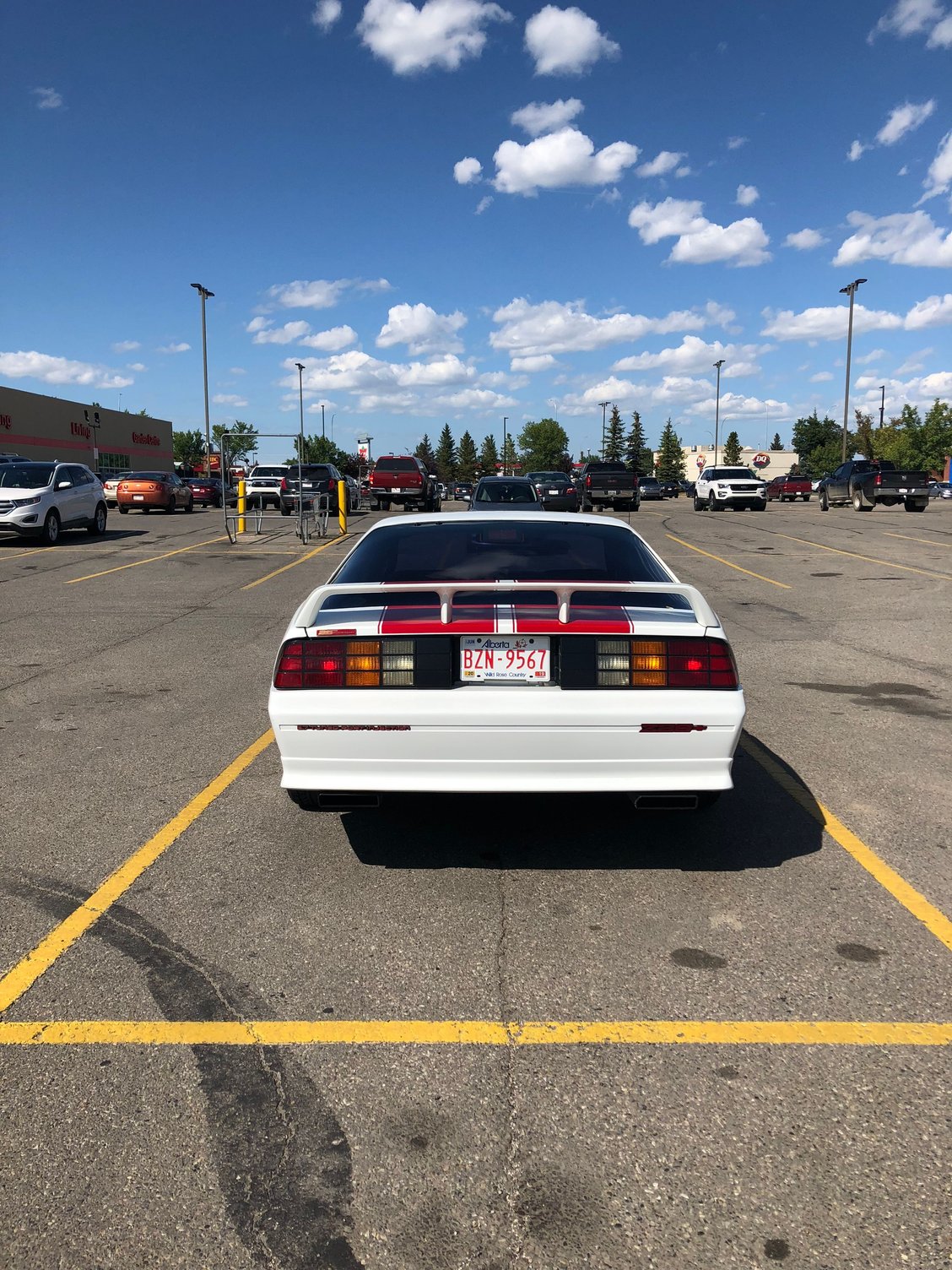

Better pics for insurance - I will be repainting from bumper area, fixing a few dents , and changing interior upholstery. Most of the mechanical has been completed now.
