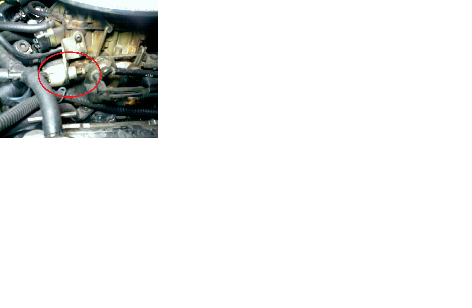

Sorry, tried searching but don't know what to look for. Could someone tell me what this is and what it does? thanks.

its below the TPS on a stock LG4.

Throttle kicker solonoid for raising idle speed when the AC is on.

looks like it could be for cruise control but not certain.
Or when the power steering pressure gets too low (some later models w/out AC)
Or when the ECM engages it during certain deceleration conditions.
No, it's not the cruise control. It's the idle kicker solenoid.
