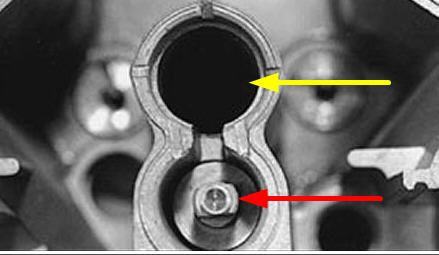

The yellow arrow is where the power valve with the two metering rods go and red arrow is where a second power valve is the hole is hollow like the top hole doesn't have anything in it like this pic as I found this on internet so my question is why do I have 2 power valves?
