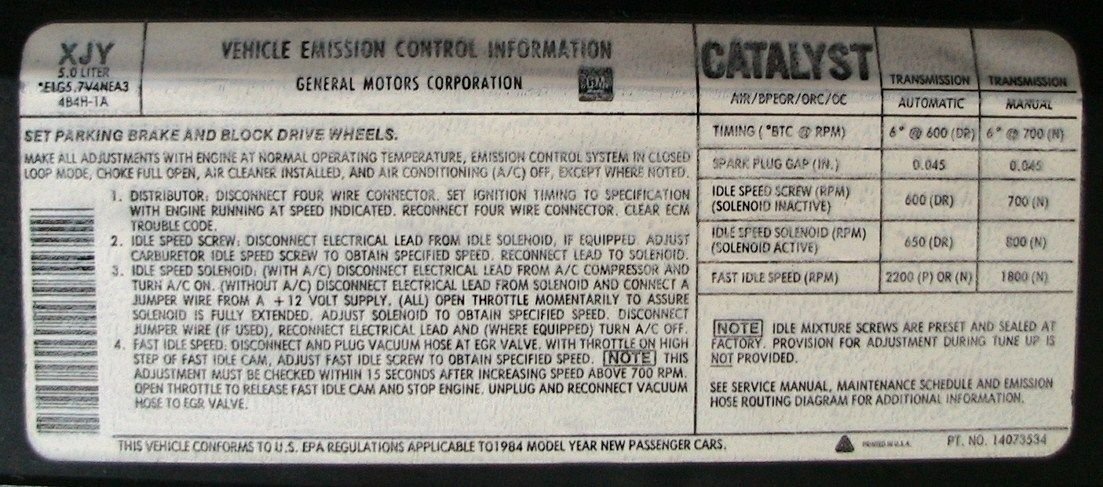

My Car Is 2 Years Older Than Yours,But The Idle Speed And Fast Idle Speed Should Apply To Yours Also.
