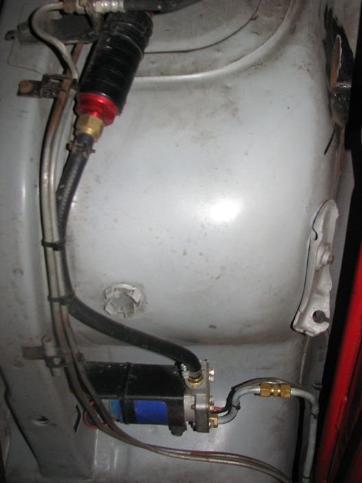

Jul 13, 2025 | 03:06 PM
Re: External electric fuel pumps - what & where?
Well, despite the noise, my old Holley Blue is still hanging in there.
Keeps a steady 5 PSI up against a return style regulator.
Originally an EFI V6, when I replaced the tank I ditched the pump and pickup. It was actually @five7kid who, about 15 years ago, sent me a carbureted pickup unit in exchange for mine. I said after the fact that I'll never drop the tank again as I find it's a PITA. The exhaust alone (being a single 3" aftermarket in the OEM location) would require cutting up to remove. Done once. Never again. If I DID go for an in-tank pump, I most certainly would cut an access panel into the hatch floor as many have done before (some nice kits out there).
The Blue pump was installed in the original EFI filter location. Pre-pump 100 micron filter and post pump 40 micron just before the carburetor.
That picture is a little dated. The lines have been cleaned up a little and that photo pre-dates and -6AN fuel return line.
I've a higher capacity radial style pump on the shelf that'll eventually replace old Blue. The noise kind of blends into the back ground but it wouldn't bother me any if it was gone. Besides, how long can one pump stay alive?

Jul 13, 2025 | 05:49 PM
Quote: It was actually @five7kid who, about 15 years ago, sent me a carbureted pickup unit in exchange for mine.
Heh. I just removed that pickup and Walbro 255 last year for a new EFI pickup and a new pump for the 416 that is now in the '82. Same carb'd V6 tank that was originally fab'd and installed by the factory...
And I have run an external pump before - not in the 3rd gen, but in the shoebox back around 1977. I also ran one in the car from 2006 to 2010. It now has an in-tank pump from Tanks Inc.
If you do run an external electric pump, mount it back by the tank.
Reply 0

Yeah. In tank appears the way to go. But on the service side, not so much. One of my racing buddies seems to be changing pumps all too frequently. Some failures I think. Others, an upgrade. But the tank has to be dropped each time (he'd NEVER cut up a floor in any of his cars to accommodate an access panel although none of those are 3rd gens).
I thought the original EFI filter location a perfect spot for an external unit. Access is good. It's a little exposed but I'm rarely, if ever, on a road or in weather that would mess it up. So far (and it's been in service for a long time), so good.
