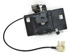

So, I only need to get the pop mechanism and the plug for it for a 4th gen, nothing else is needed from the 4th gen latch assembly, correct?
Attached Thumbnails Adding a remote trunk release solenoid straightforward?-4th-gen-trunk-release.jpg

Re: Adding a remote trunk release solenoid straightforward?
Thats it

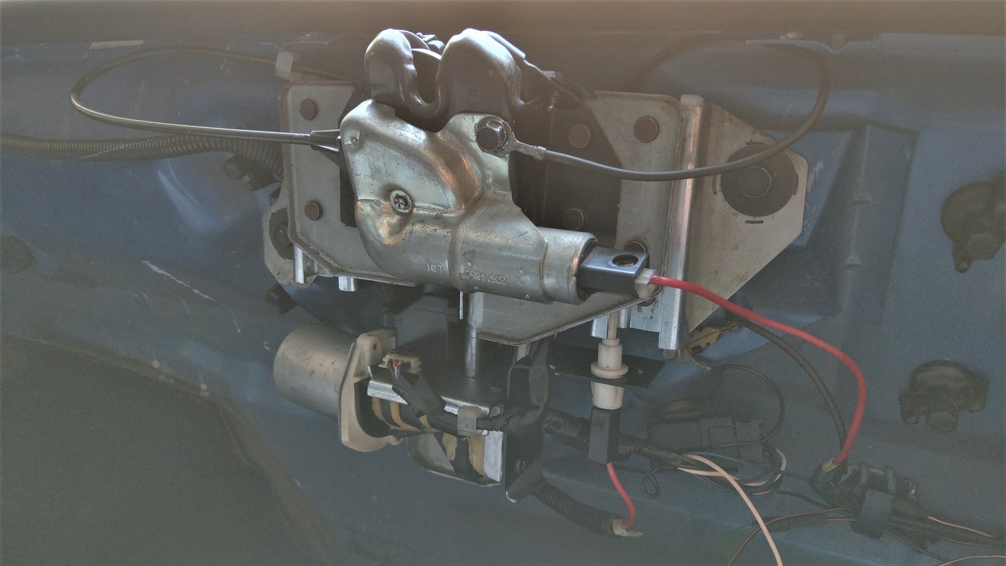

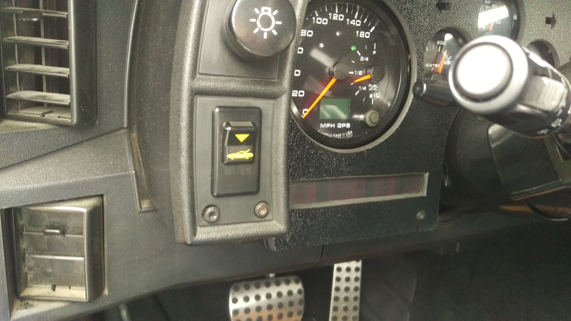

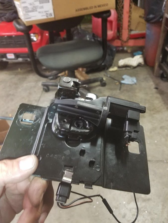

The early pulldown has provisions for a solenoid? This is a solenoid i got at the JY, i got the hatch switch form a 96 vette and put it where the fog light switch usually goes. The relay is down by the kick panel. 92 is a different animal though, but looks a bit like some trunk/4th gen units, minus the fiberglass board.

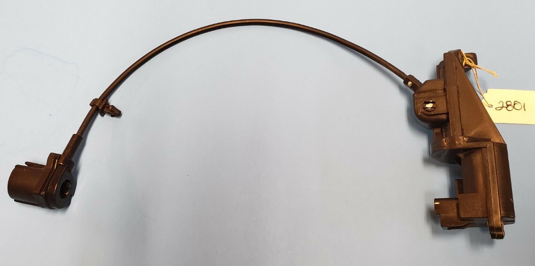

Well when I read this tread a few times more I understood a bit of what I was asking for already had been answered but new questions came to mind.

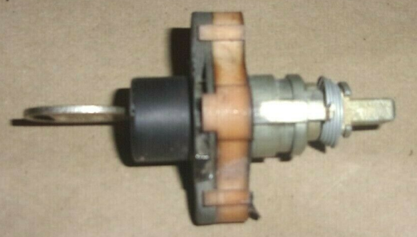

86GN has a very good solution here but as I can see the 4th gen solenoid has bolt holes at an 45° angle, Did You grind down the mounting tabs on the solenoid?
I found that mine has an eccentric wheel on the back side used for nothing and thought I could do a search for similar on GM cars around -92 to find a direct fitting Solenoid.
My lock with the eccentric reraward looks like this:
I did not find an actuator that fit my eccentric (I'm sure there are one that fits thou) but I found one that had the cable and solenoid in the same unit. ACDELCO16640852 Should fit the lock cylinder originally in the -92.
But this also had the mounting holes 45°
86GN: Does it hold up good? Do You remember if You did grind down the mounting tabs to get it aligned?

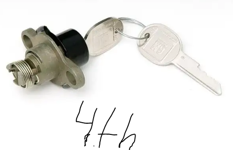

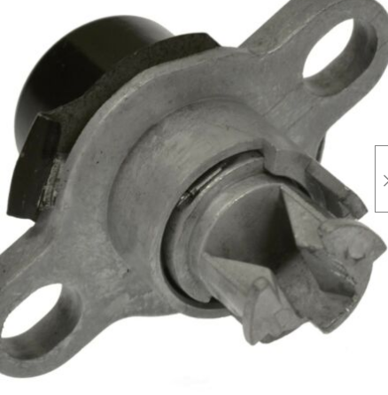

I guess use of the cylinder rod extension also need the other type of lock cylinder, as the 86-92 does not have the slot for the rod? Pre 86 and/or 4th gen?
4th gen:
86-92:
Pre -86:
Old Feb 18, 2022 | 03:30 PM
