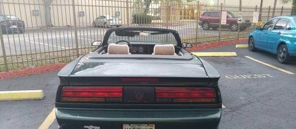

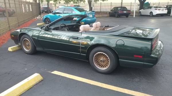

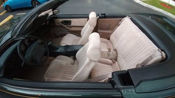

I'm buying a 92 firebird vert......
Want some details on doing the following....
1-4th gen rear (will GTA wheels work)
2-GTA digital dash
3-access panel for fuel pump
4-swap TBI for TPI
5-GTA steering wheel with radio controls
6-replace top.....( can this be done at home )
7-swap firebird tail lights for 2 piece TA lights
Thank you in advance

The rear end swap is straightforward, unbolt the old and bolt in the new. The ebrake cable will need changed and the wheels will need to be changed since the 4th gen rear is wider. I have done the TBI to TPI swap but anymore I say it's just not worth it unless you got all the swap parts for cheap or free. The swap requires that you drop tank to change the pump (You do that for an LS swap), repin the wiring harness or use a new one (you do that for an LS swap), Change everything from the intake up except for the dizzy (a dozen more bolts and you'd have the engine out for an LS swap) You can do an LS swap for not much more time and money if you use a truck 5.3.

The steering wheel and digital dash is just some additional wiring to run or swap over.

Finding a set of 91-92 TA Taillights in good condition is going to be hard and expensive but they should just slide in and screw down.
