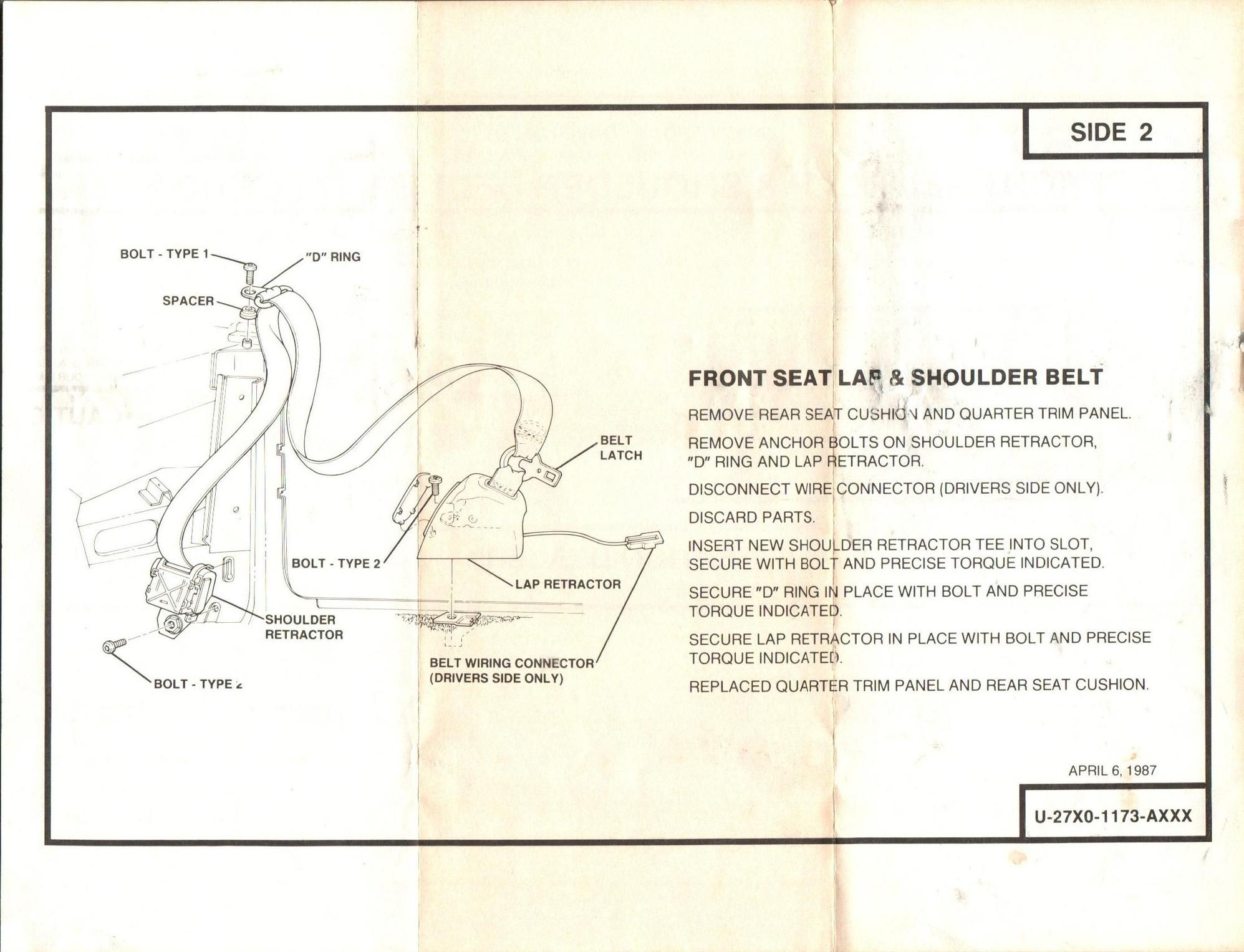

I'm in the midst of replacing my front seat belts with a pair of brand new NOS belts. In the box was the GM instructions for them. Not sure if anyone wants these, but I'll post them anyway.

Here are pdf's if people prefer to save these instead of jpegs
