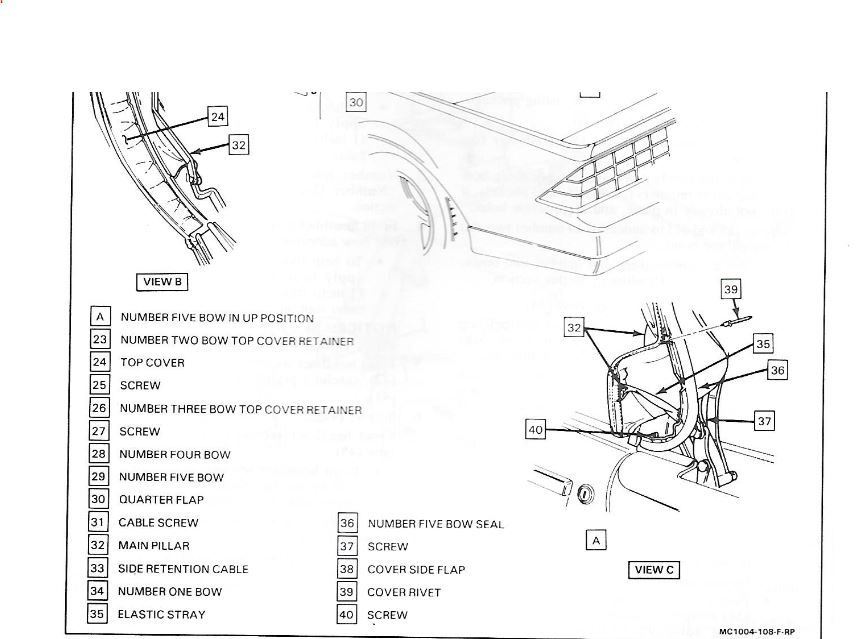

probably too late but mine uses that strap there is a Philips head screw threw the strap
#35 below is the strap
