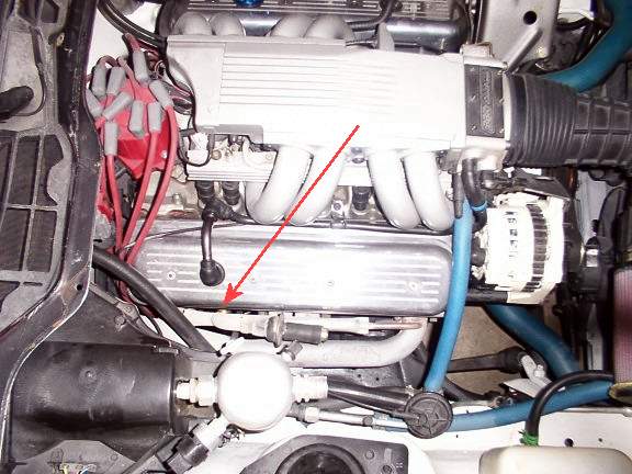

OK i got a 213 turn on, fan switch from napa for my 91 5.0 tbi rs. I have looked on the passengers side near cylinders 6-8 and cannot find it. Could you guys give me a bit more help here like top bottom left right, front, rear, ect... Thanks.
Old Jul 1, 2002 | 04:56 PM
deadbird's Avatar
Joined: Sep 2000
Posts: 6,775
Likes: 28
From: So.west IN
Car: 87 Formula/ 00 Xtreme
Engine: TPI 305/ v6
Axle/Gears: 3.08/ 3.23
Attached Thumbnails How in the heck do you install a new fan switch???-dcp_0021.jpg
Old Jul 1, 2002 | 06:24 PM
Jokerman's Avatar
Posts: 595
From: Schaumburg, Illinois
Engine: slowtacular L03 305
Transmission: slushem 700r4
wow thats probably the most perfectly clear shot in the world. Thanks. Now i have a project for tommorow morning.
