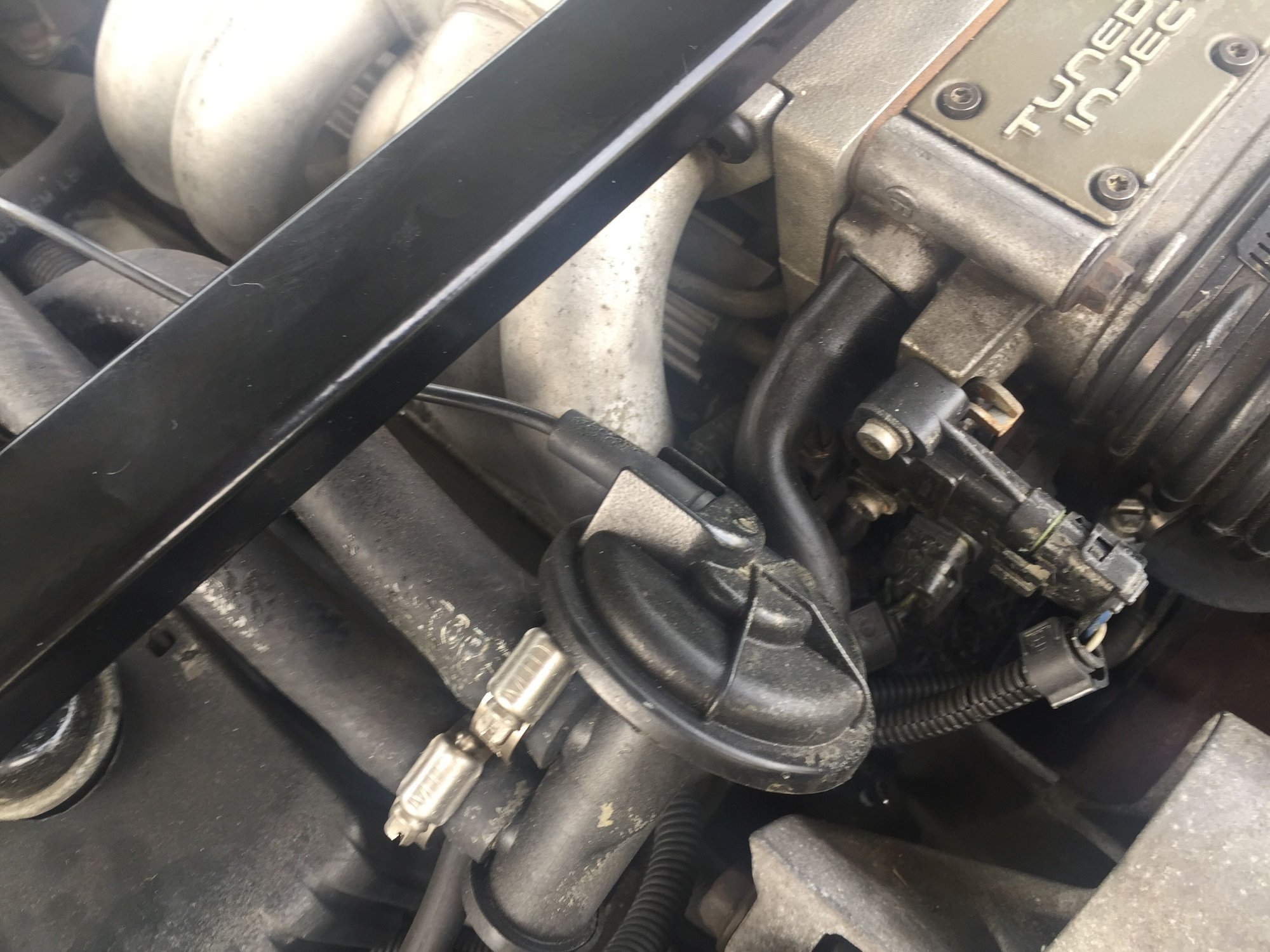

Just as the title says I get absolutely no heat from my heater. The car does not over heat, and when I check the radiator it hasn't lost any antifreeze. So my question is what is going on here? Could it be that the heater core is clogged? Would a drain and flush clear the problem? I can turn on the heater and I feel air flowing, but its just cold.

do you got these hooked up?

These two? They seem to be hooked up. Could they have failed by chance? Maybe I can try to replace them?
Feel the hoses at the heater core while temp selector set to hot, no blower. if one hose is warm/hot, the other cool, core is not circulating.
Heater bypass valve, as youshow above, only works on full cold (applies vacuum to bypass core). Set at warm-hot, pull vacuum line at valve. If you have vacuum on line, hvac vacuum valve is bad (on control unit in car).
