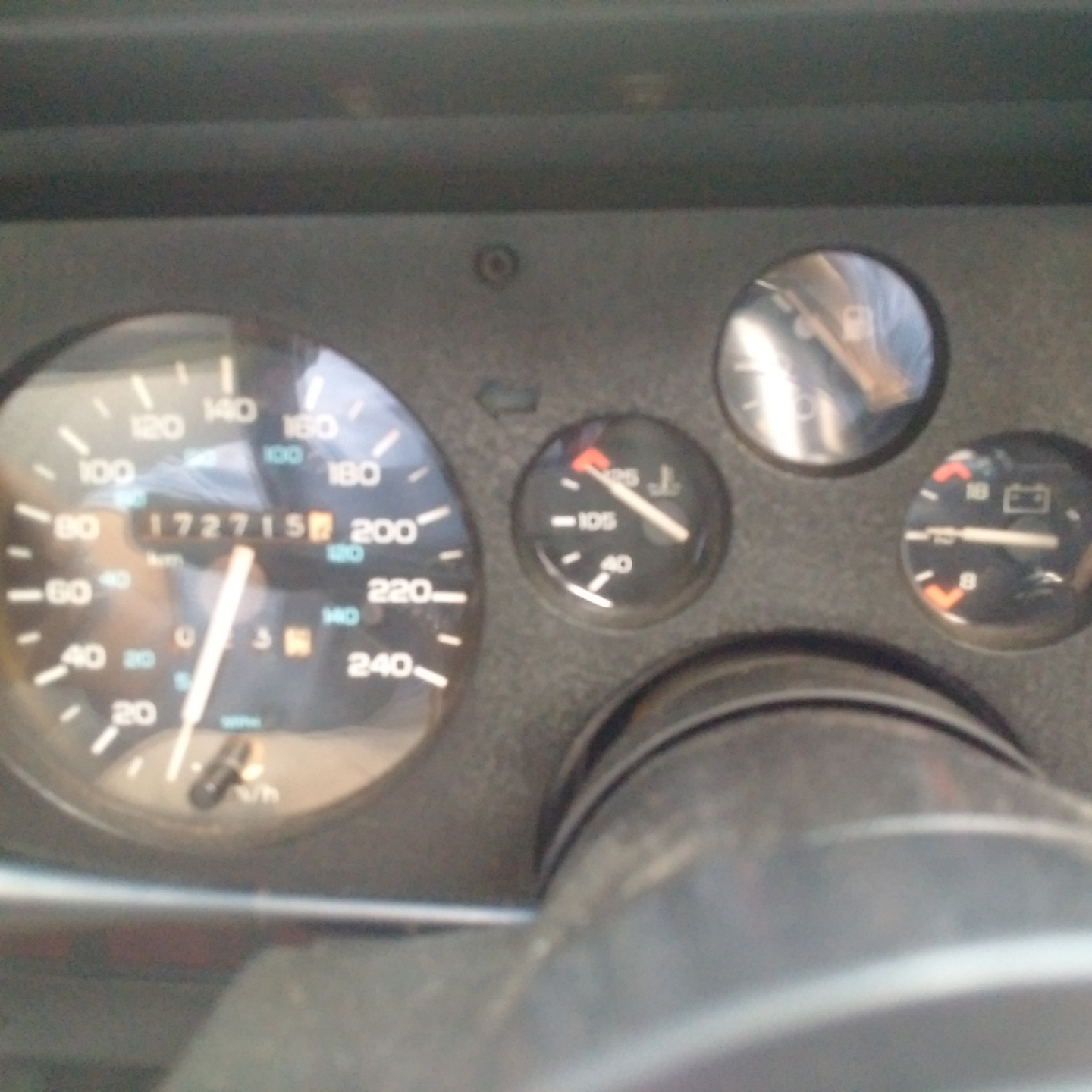

OK like many I don't like sitting in dead traffic in the middle of a hot summer day with the rad air dam doin bupkis staring at this (both fans verified running at this point BTW so at least the stock system is working to spec..) Granted the gauge may be overstating but just the same.
