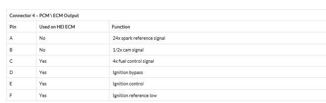

Im not sure if this helps to start making a schematic with. I look at it but couldn't figure out if the four wires that use to be for the hei icm went to the 6 connecter plug with the crank pickup.

Compare the seven pin HEI wiring w/the N* DIS, and we have as follows...;
HEI 7 Pin ICM (Four From The ECM);
* EST (Electronic Spark Timing)
* Reference Signal
* EST Bypass 5V Out
* Ground
Northstar DIS ICM (Excluding Cam/Fuel);
* Ignition Control
* Reference Signal
* Bypass
* Ground
... I excluded cam/fuel because I am staying batch fire.

http://m.ebay.com/itm/121471842443?nav=SEARCHA little more code info and reluctor info to add to this topic.
http://www.mastercraft.com/teamtalk/....php?p=1090285
https://www.thirdgen.org/forums/diy-...y-dizzy-3.html

No doubt neat bracket to copy with a non serpentine setup.
This is the best deal I found on the crank position sensor.
Amazon.com: Delphi SS10090 Engine Crankshaft Position Sensor: Automotive Amazon.com: Delphi SS10090 Engine Crankshaft Position Sensor: Automotive
Another style that was use I'm not sure if shorter L31 pickups would work I don't see why not reluctor size dependent.
http://mcpartsdepot.com/collections/indmar?page=29
Attached Thumbnails EBL-P4 w/Northstar DIS Ignition System...-image.jpg
