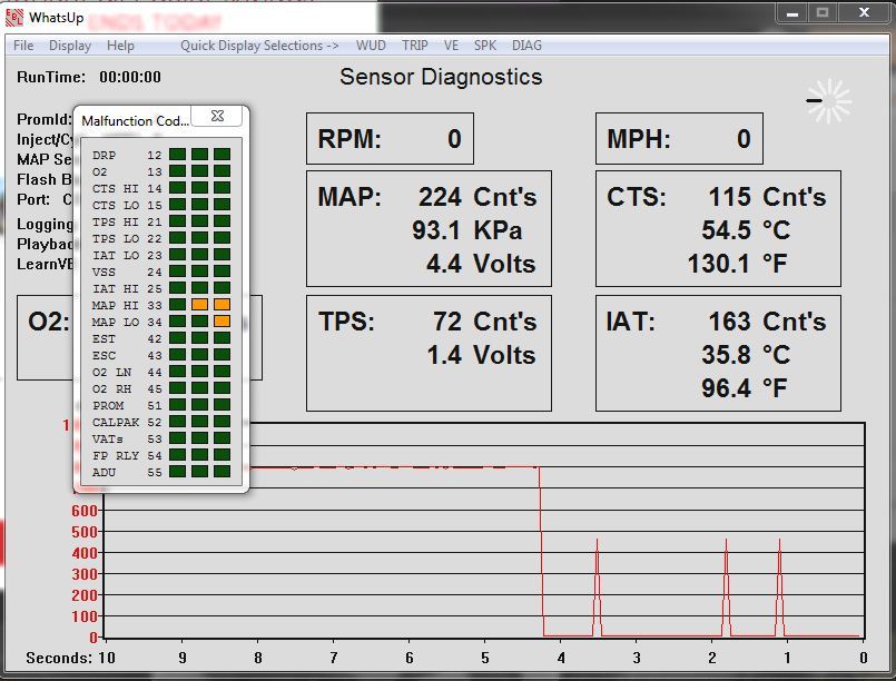

Finally got around to installing my EBL flash on my 87 GTA today. Followed the re-pinning provided by RBob, however instead of using my old MAF signal wire, I used the Air converter wire (pin C2) for the MAP signal. Edited the suggested bin and flashed it. Car fired up but immediately threw codes and running rough. Looking on the WUD malfunction codes looks like I get 33 and 34. Not sure what the three rows mean? Either way, what did I do wrong here? Any help would be greatly appreciated.

Got that issue resolved. Used wrong wire for ground looks like. No codes now. Starts and runs but idle is consistently up and down. Thinking maybe I need to do some VE learns now.
