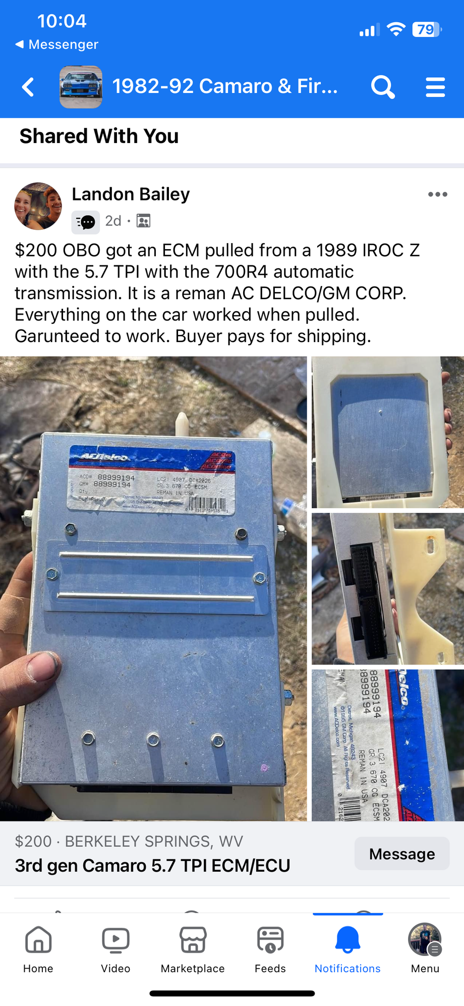

The 165 is getting hard to find right now. You might look into this one.
https://www.facebook.com/groups/974267102592684/permalink/7511601188859210/?sale_post_id=7511601188859210&mibextid=W9rl1R
