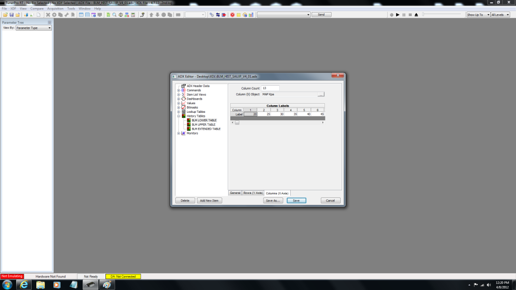

Okay histogram time, load you adx file in tp, on top acquisition, edit definition, click on history table and add new item, give a name and id, output object is going to be blm, next click on rows, row count ( here were doing the lower table first) 13, this is going to be our rpm's so object here is rpm, fill in the row like your lower ve table, so 400rpm in the first and 1600rpm in the last, next click on columns, column count 13, fill in again like you ve table, starting in 20kpa all the way to 100kpa, for obvious reasons object is kpa, now save.
So now you have something that looks like this. Next up how to use it and how to use it with the excel tool.
