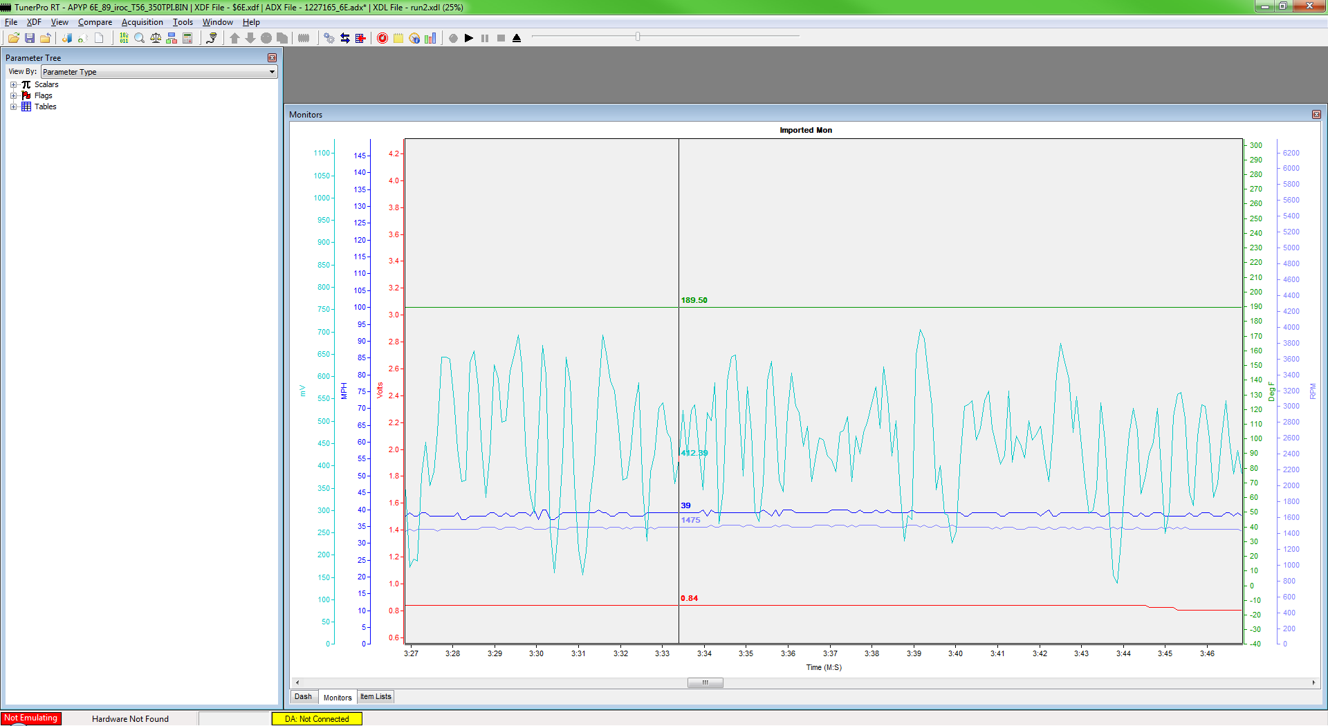

Dont have experience enough to know if this is normal. Can anyone take a look real quick?

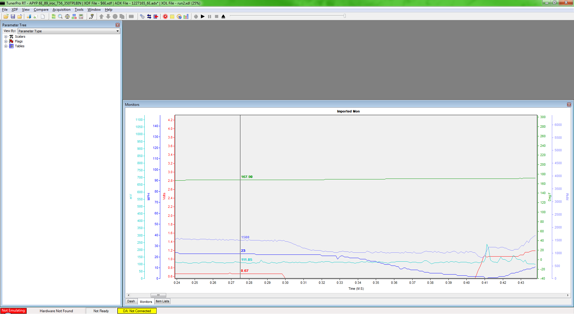

First pic is at the start of a 10 minute drive.
Attached Thumbnails O2 sensor going crazy, no codes?-o2-sensor-initial.png   O2 sensor going crazy, no codes?-o2-sensor-final.png

The only thing I see is its taking along time to become active like the o2 is not heated and in headers. What do you mean bye your o2 is going crazy the swing ?

Yeah the whole 150mv to 700mv thing in half a second. I thought it was supposed to remain somewhat constant? Also trying to diagnose what is making my car shutter under load at low RPM's.
EDIT
Just drove to work and got a code 32. Hoping that is it.

The o2 swing looks good, watch your blm and int. IIRC when the egr malf 32 hits The ecm goes into lhm. most of the time the code 32 will throw for a faulty egr temp sensor. You can still have egr function if the malf is disabled.
