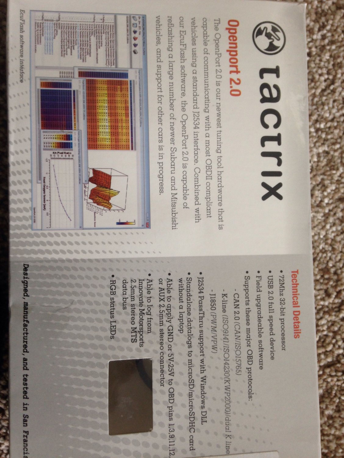

Originally Posted by neruve
What cheaper interfaces are you referring to? I'm intrigued.
There is one in particular I have in mind, which seems to support both of the necessary protocols and costs closer to $100. The problem is, neither the manufacturer, nor anyone else I can find, thinks the thing will do VPW 4x, which is a necessity to write to the PCM. Yet their specifications say otherwise. I'm corresponding with dimented about this, and hope to get a final declaration as to what's right/wrong, up/down. Meanwhile I'd prefer not to get anyone's hopes up.

Re: Houston, we have reflash... PCM reflash tool
Tactrix is awesome. The datalogging direct to sd card I love.
