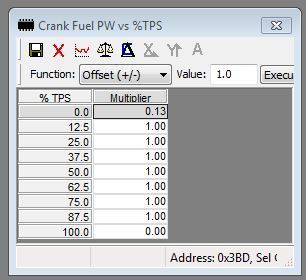

I am using the Super_8dm2.xdf, and recently noticed that this table WAS NOT in my xdf, for some reason. So i added it in, from TP, based on some other info, and looking at the table parameters from my $6E xdf. I am using a modified ARFP bin, and i think the table address is off by 1 clik. I started it at 0x3BD, but i think it should start at 0x3BE. The first entry in my table comes out to be a multiplier of 0.13, and i think it should be 1.00 at zero throttle. At least that is how many other bins have it. Then at the 2 high throttle positions, goes to 0 for clear flood. Check out my snippet, and let me know what I did wrong.......

You are correct, table start address is $3BE
The value at $3BD is the table line count.

Thanks RBob, just what I was hoping for. I will make the correction in my xdf.
