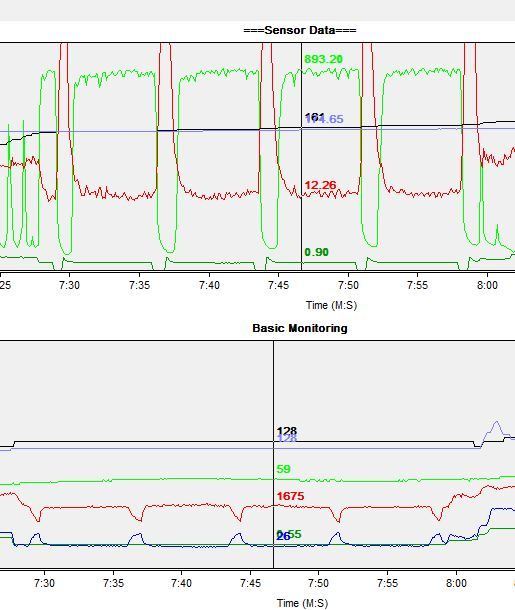

So today's morning datalog into work, got real good data. More about that in a sec, but the pm ride home gave me some data, but the log stopped as i had a com issue. happens with 165 ECM. While i was slowing down, from 60 -49, closed throttle, I hit this rich condition, high O2 volts, rich AFR, and low IBPW. But i was not in DFCO for sure.
Now for the morning ride in, down this long big hill, i hit the rich condition again, with throttle closed. But i also got something else, 5 "lean spikes" during this rich condition. I dug into more, and it was DFCO mode for sure. The IBPW went to 0, rpm dropped a little, AFR pegged lean. These 5 spikes were quite symmetrical and periodic. So, i looked into my DFCO settings, which you know are only scalars, no tables. I have not messed with any of these values, so they should be the same as stock ARAP. It appears that i am set for 1 second in DFCO, and 6 seconds in delay.....pretty much exactly what i recorded. Waay cool!! I like to see things working! So why this logic, only 1 sec in and delay for 6? to protect the engine? I guess sparking and no fuel, should be a brief event? How do you run with it?
There is one setting in there, that I am not so sure about. For %TPS, enable less than 3.1. But for TPS volts, enable less than 0.16, which seems impossible, since at closed throttle, my volts is 0.55. Will never get less than that. So what up with that?
For my default and min IBPW, they are both set to 1.587mS, stock values i think. I been wondering what these values do. If i lowered them, maybe i could avoid this rich condition? Once i get my tune dialed in, i will likely go back to highway mode, which will likely mask or avoid DFCO. I think there is more control in highway mode. Check out my snippet of this down hill datalog.....very similar to what you have seen.

The short duration dfco events are likely due to the load hovering near the enable/disable thresholds. You could increase the hysteresis between them or simply allow dfco to occur at slightly greater load like 50-60 counts in order to stay in dfco longer until the load is increased again naturally via the throttle opening (and increased airflow/rpm).
Reducing both the min pw and default values should allow it to run leaner (assuming the injector still responds to the reduced pw). Highway mode only increases the target AFR, so it won't help with this issue. To run leaner you must reduce the min pw settings, allow easier entry into dfco or run in single-fire mode. Good luck.
Note: I don't like single-fire mode due to the rough transition into double-fire upon PE entry. It may be tolerable with small injectors, but not so much with 63 lb/hr injectors or larger.

Ya, i can mess with all them parameters for sure, to keep DFCO active longer. Does it hurt the engine to run with 0 PW for a longer time? I dont get the one scalar, for DFCO enable if TPS volts < 0.16. Seems like the voltage would never get that low.
So, i did already make a new bin, lowering the min PW, and a few other small changes. Drove car today, but did not datalog. Going down the big hill to work, i was watching my gauges, and it looks like this change might have helped. But a datalog will tell me for sure. Good stuff!
