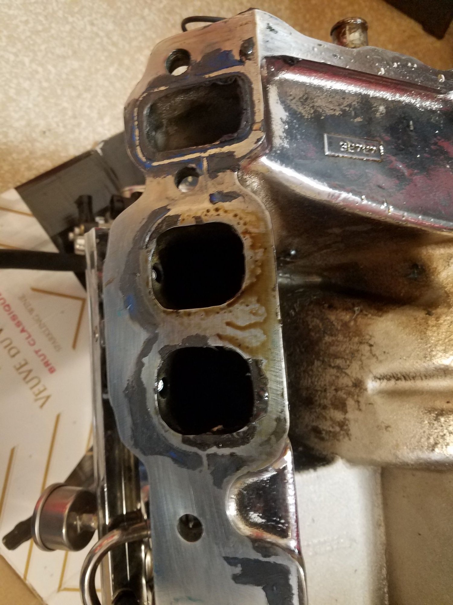

I replaced a leaky intake manifold gasket for the third time. Drove around with the APU 1 emulator. Open loop idle, Closed loop above 1,000 rpm. Drove fine. Stopped and changed to full time open loop. Drove fine. Stopped to get some fuel. Started back up and barely ran. Full lean. Didn't change anything other than stopping and starting logging and the dashboard. Barely made it home. I assumed something wrong with the APU. So, pulled the APU and installed a PROM with the same BIN. Still full lean. No change in Fuel Pressure about 35 lbs at idle. 45 lbs without vacuum. Changed from Open loop to Closed loop, including idle. BLM all the way to one end and full lean.
I didn't do anything but get gas. Busy EXXON station in town. Even if the gas was bad, it would barely start. Fuel rails still had original fuel.

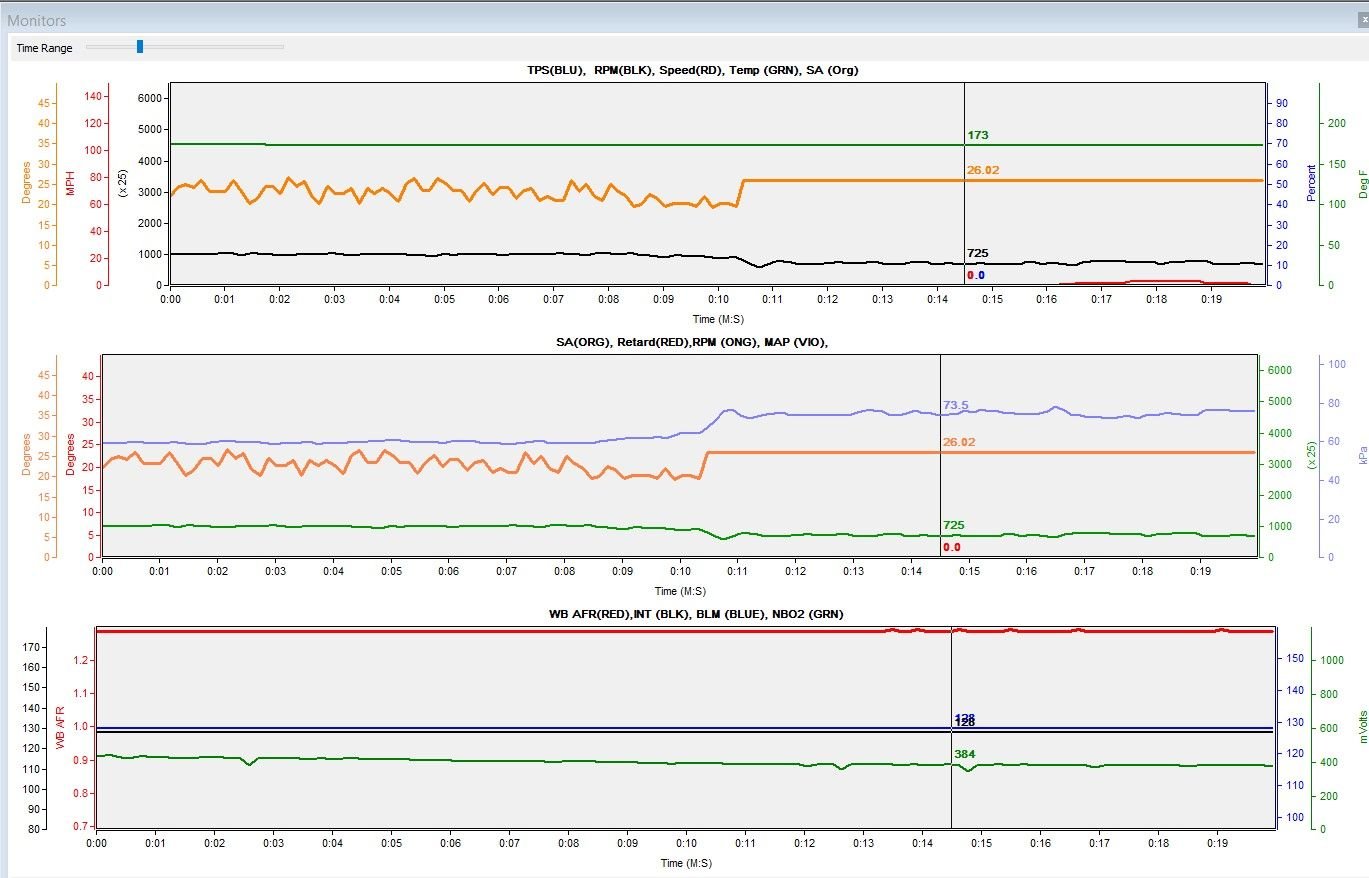

Looking at your log, you are in open loop the majority of the time. Your MAP values are high at idle. Other than that, it's hard to say. Why run in open loop? At certain point, when in closed loop, the BLM are high in cell #5 (140). So definitely lean. Was that before gassing-up?
Old Feb 14, 2023 | 11:52 AM
SbFormula's Avatar
Joined: Jun 2012
Posts: 1,371
Likes: 196
From: Canada
Car: '18 Chev Camaro SS 1LE
Engine: LT1 6.2L
Axle/Gears: 3.91
Re: Dangerously Close to Switching to a Carb
By the end of your log (172), your are in cell#4 at idle, lean, but stuck at BLM 128 because open loop. Your commanded AFR is 14.03 instead of 12.55 at beginning of your ride.
That is due to a higher commended idle rpm which leads to lower MAP = leaner OL AFR
It seems like the lower your engine idles, the higher the MAP value is (less vacuum). Probably your cam profile.
Higher MAP value translate into lower AFR in OL (due to tune)
Also, the lower the engine temp (CT) the higher the OL AFR is (due to tune)
For example:
Beginning of ride in OL at idle = 1125RPM / CT149 / MAP54 = 12.55AFR
Middle of ride in OL at idle = 900RPM / CT192 / MAP67 = 13.65AFR (I noticed IAC is at 231steps!!!! Unless my XDF is wrong)
End of ride in OL at idle = 1000RPM / CT185 / MAP54 = 14.06AFR (I noticed IAC is at 9 steps!!! Unless my XDF is wrong)
So this OL business yields unstable commended AFR. OL AFR is calculated using the following parameters:
Commanded AFR
Start-up AFR change
Start-up AFR change decay delay
Idle AFR change
CT AFR change
MAP AFR change
MAT AFR change
When you were riding in Closed loop, the BLM were correcting lean condition (up to 142 in cell#5). Later in your ride, the BLM was locked at 138 in cell#5 in OL. Maybe it needed to add fuel but could not.
Again, why do you run OL? If you want to do so, you'll need to tune OL to take into account, engine temperature, MAT heat soaking, MAP value and idle mode.
When exactly in that log did you start having trouble I don't see any SES error. Except stored code. See picture.

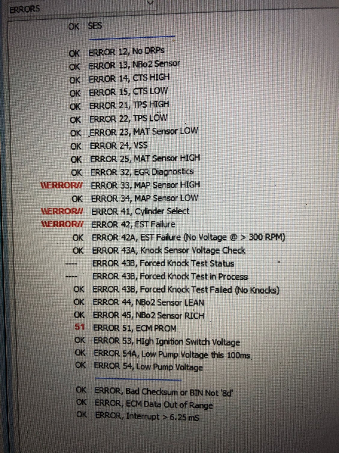

3. Where did you see the error log.
TunerPro, Acquisition, Show Data List, drop down menu: ERRORS
thats in my own XDF
What is the 51 ECU error?
Dont know off hand. Search TGO
Code 51 would be thrown if it’s in limp home mode not running off bin or bad ecm.
I see code 33, 42 and 51 in the datalog.

This is interesting. Tune 173A was done on the on the lift. Just idle. Ranging from cold to operating temperature. BIN is OL Idle and CL over 1000 rpm. This is the last half minute of the log. The bold Red line in the lower monitor is the WBO2. Looks a little lean but pretty decent. Considering that I had dropped the Fuel Pressure at idle a bit, lead would be expected with the same VE table as with the higher idle pressure.
Now, look at this. I turned off the engine, lowered the lift. Started the car in preparation for a test drive. This is log 173b. Same BIN. Only difference is I turned off the engine and restarted it a few minutes later. Look at the WBO2 in the lower Monitor panel. Locked at LEAN. Look at SA in the middle monitor. locks in at 26*.
Dib

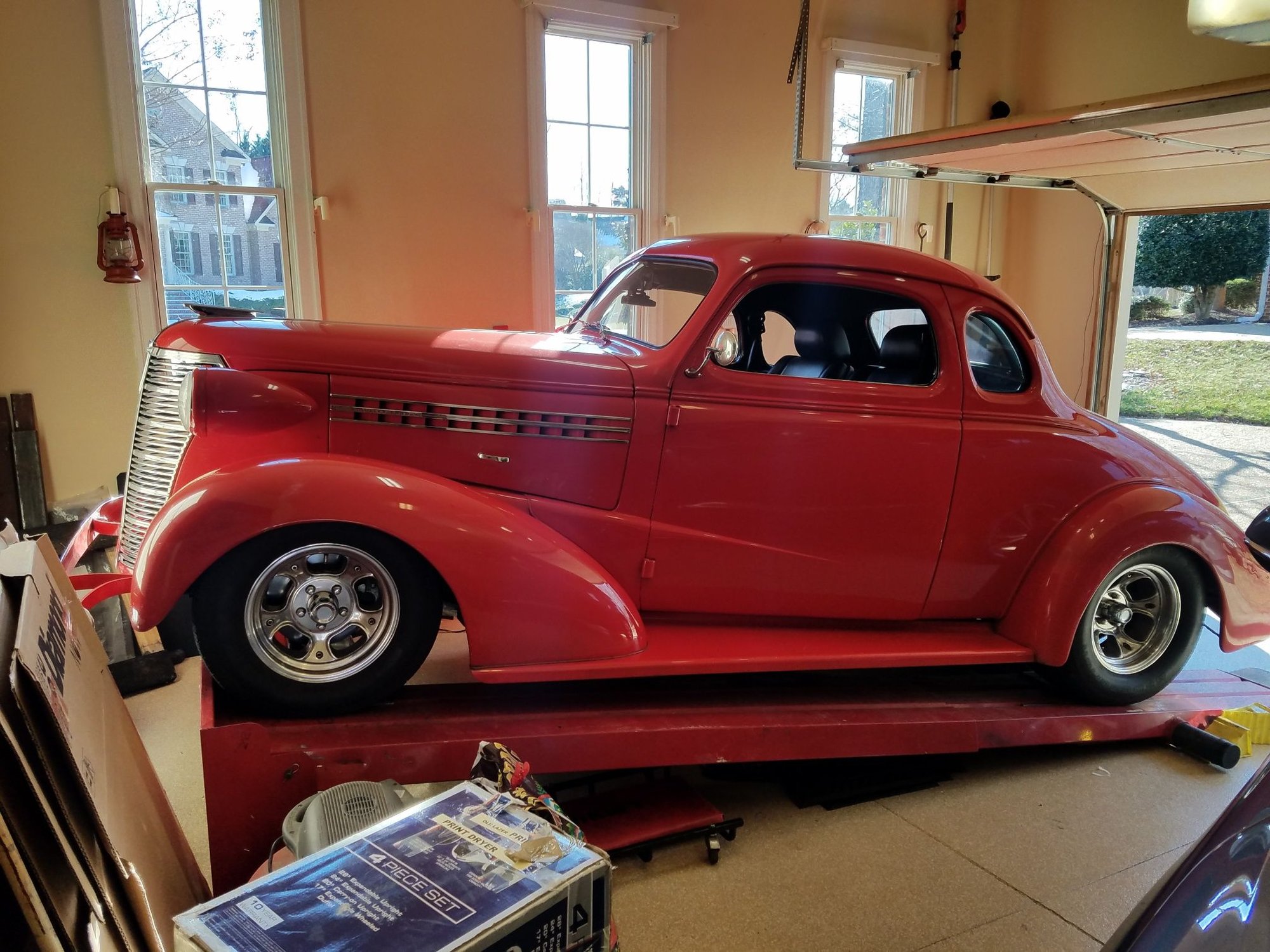

The lift is an EZ lift that you drive up on.

That car is beautiful sir! I am biased though, I have great love for 1933-1939 Chevys as well as a few select years of Buick, Cadillacs, Oldsmobiles and Pontiacs in that same era.

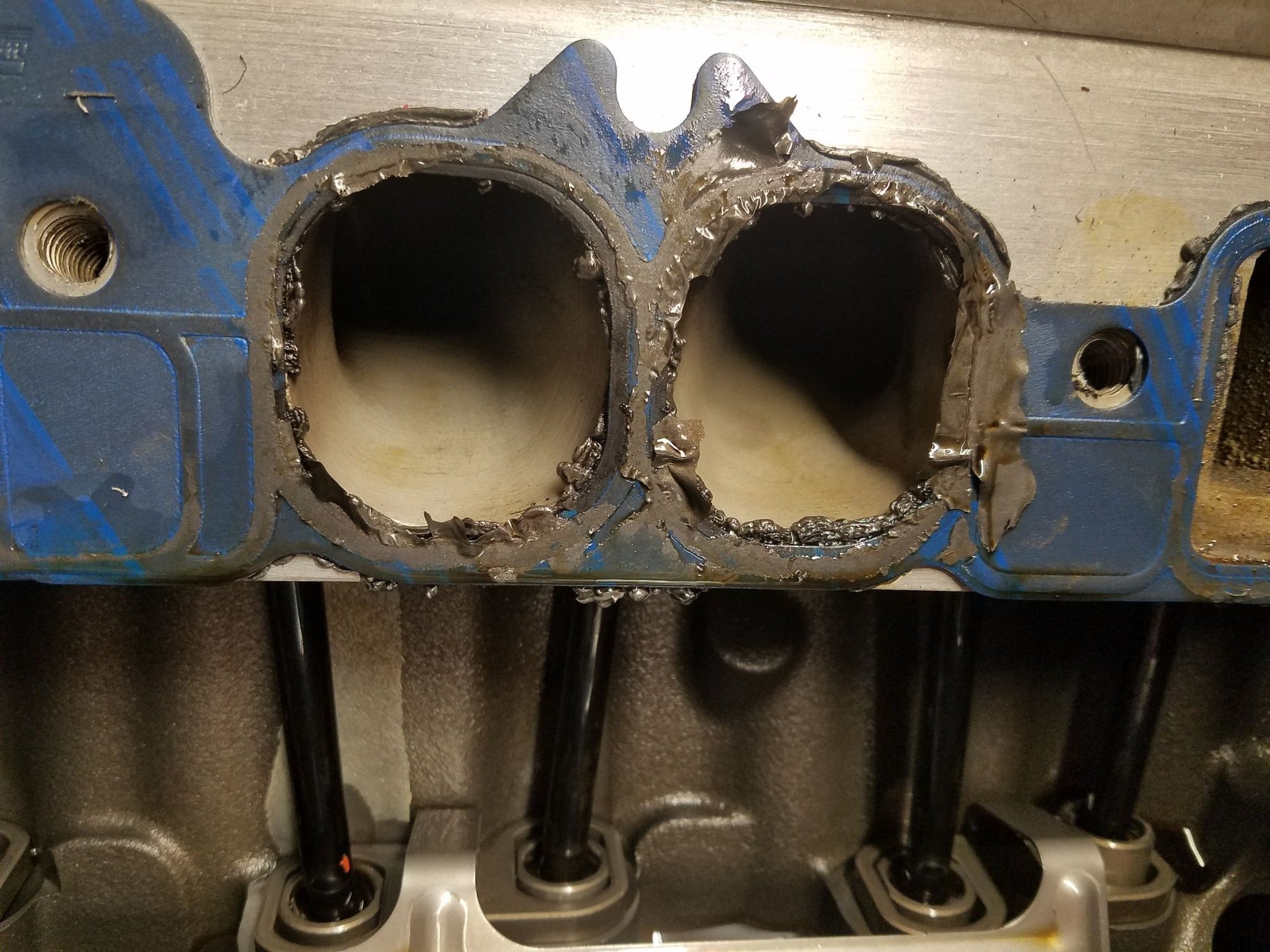

The intake manifold on this beast is too heavy for me to carefully align when installing. The multiple times of installing is the result of several issues unrelated to the intake gasket (like no sealer on the rocker arm studs that run into the intake runner). This last time, I built a pulley system to lower the manifold and used Gasket cinch and some fuel proof gasket dressing. I have in dash gauge for Fuel Pressure and the FP is good when the car is lean. Something odd about the fact that it can run great until you shut it off. A hot restart is pure lean. It does sound mechanical, but I am at a loss as to what it could be related to the restart. The difference between a decent log and a bad log can be two minutes and an Off-On of the engine.
I think it's in the ECM/BIN/Wiring someplace.

Here's something interesting with 173b. Follow the logic.
During your long idle period (second half of 173b)
ECM is trying to bring down idle to commanded 900rpm. IAC is decreasing from 134 to 64 (all normal)
RPM is at 1200rpm going down to 900 rpm
MAP goes from around 50 to 63
Commanded AFR is 14.19 down to 13.77 (because MAP increases)
Since its over 1000 rpm, BLM learn is activated. Its in cell#5 at BLM 160 maxed out with INT working its way up to 140s (means ECM is adding up to 40% injectors calculated PW)
However, as rpm reaches commended 900rpm and crosses the 1000rpm threshold, ECM is in and out of closed loop. Means the BLM locks at 160 but INT resets to 128 leaning out
THEN... ECM enters cell#4 because rpm is around 900rpm. BLM is 128 in cell#4 and in open loop.
That triggers a major drop in fuel supply, rpm drops to 750rpm, ecm enters cell#8 with BLM 128, MAP increases to 75 (very high for idle), IAC starts correcting, AE-MAP is triggered due to fluctuation in MAP
RPM won't go up
IAC maxes out at 231 steps incapable of bringing idle rpm up to 900 rpm.
IAC is adding air to an engine that has already too much air, lean in open loop unable to correct with BLM/INT. It's stuck in limbo, chasing its tale
And then, out of nowhere, ecm pulls timing from 26* to 19*, rpm goes up, and its out of limbo, back to cell#5 with BLM at 160 and INT at 140, IAC goes all the way down.
So you have a warm engine very lean.... and it gets bug down in limbo again with low rpm, high IAC, and 26* of timing.
Conclusion: Your VE tables are too lean and your engine does not generate enough vacuum under 900 rpm.
Probably why it won't even approach a smooth idle below 900 RPM.

"I replaced a leaky intake manifold gasket for the third time."
That's seems to be what started the problem, right? How did you known it was leaky? What data or testing made you conclude it was leaky? How can the car be reliable if it had a leaky gasket? You changed the gasket and it became unreliable?

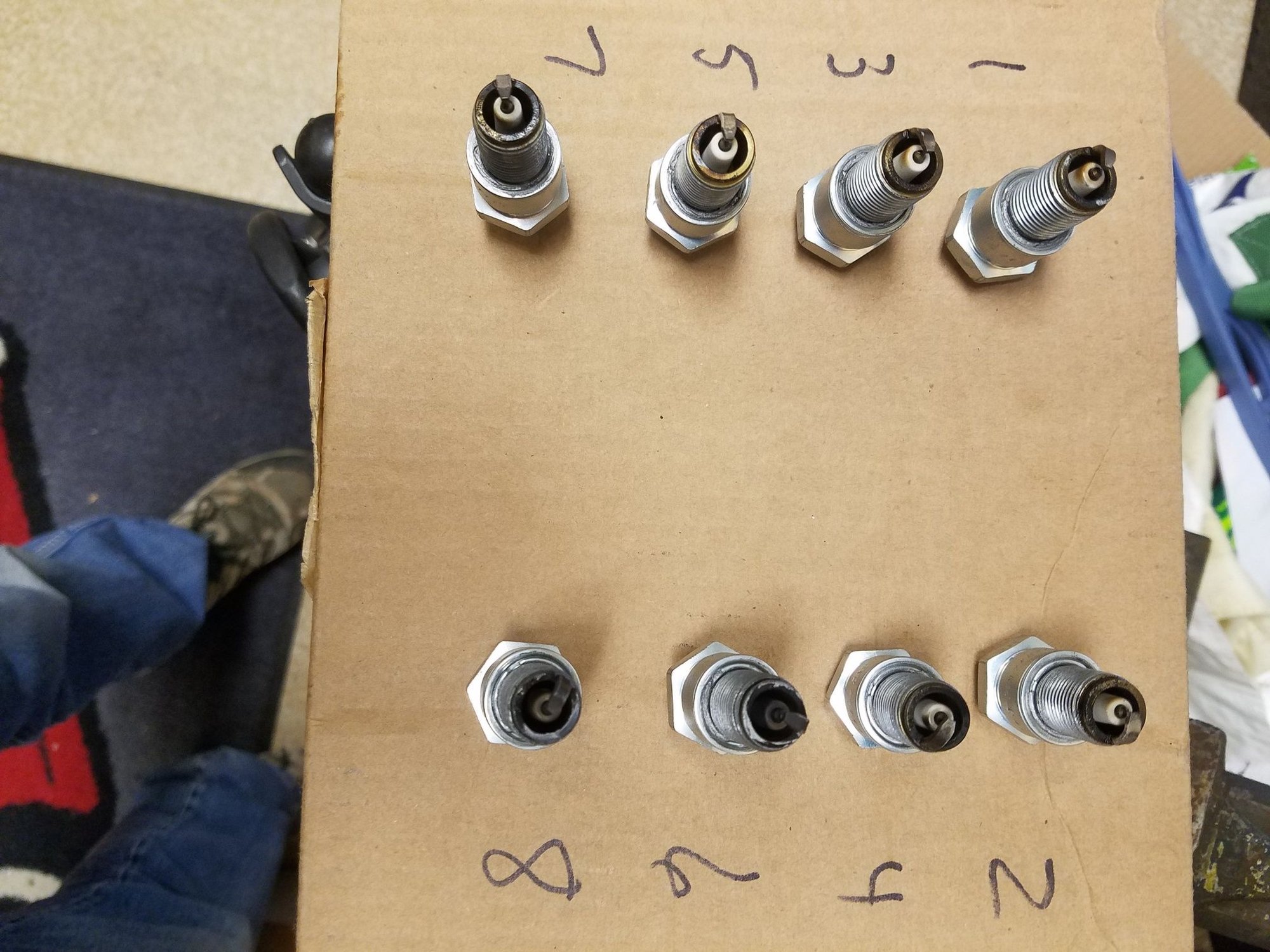

Drivers side has always been clean. Passenger side has always had the issue with fouling on six and eight. Mostly six. These plugs photos before I changed the intake gasket. Six/eight reason I figured was bad seal on intake. This car has never idled smoothly with the new short block. It has had some decent tunes though. This going full lean is something new. Fuel pressure is good, so don't think it's a filter issue. I can hear the injectors, but could be some debris in an injector. The plugs I have in now are one range hotter than the ones in the photo

GAsket cinch on the bottom of the Edlebrock intake Gasket. Permashield gasket dressing on the top. Torqued to 25 ft#.
A vacuum leak would cause the AFR to go full lean?? Why does it seem "sorta normal" until it gets to op temp?

My SWAG? The ECM is going into and out of malfunction 33, MAP high. It will do this prior to setting the SES/CEL (you do have one, right?), and before setting a code.
Once the ECM detects a 33 malfunction it creates a MAP value from some calibration tables, and uses it. You don't know this as the ALDL stream only has the ADC MAP value.
With the ratty cam, these calibration tables are no longer calibrated. In N-Alpha mode the ECM is going to create and use a MAP value that is lower then the real value. Boom, lean along with SA changes.
Get the MAP/BARO ratio value into the data stream. With that can see how much to change the malf 33 threshold to prevent this issue.
Or, disable the test. There appears to be several ways to do this.

Disabling the test would be a quick way to confirm the problem. How do you disable the test?

Flick the switch off at 0x24A, switch 24A-1 and 2 , Code 34-33

Your tune is set at:
High MAP code #33 = 0.85 ratio
Low MAP, code #34 = 0.148 ratio

Originally Posted by SbFormula
Yep!!! It seems to be consistent with what the ecm is seeing. Low vacuum. Just clued in!!! You don't even have a TPI. What the heck are you doing messing around with the '7730 ? Get yourself a modern EFI or go carb. There must be a modern EFI system that can accommodate your set-up.
The 7730 will EASILY run this setup. Just have to start with the basics and tune it. No such thing as too little idle vacuum. Just have to tune the fuel and spark accordingly. I have done 7730s with about 7 in/hg @ 1,000 rpm idle vacuum. 7730 can easily handle this engine.
