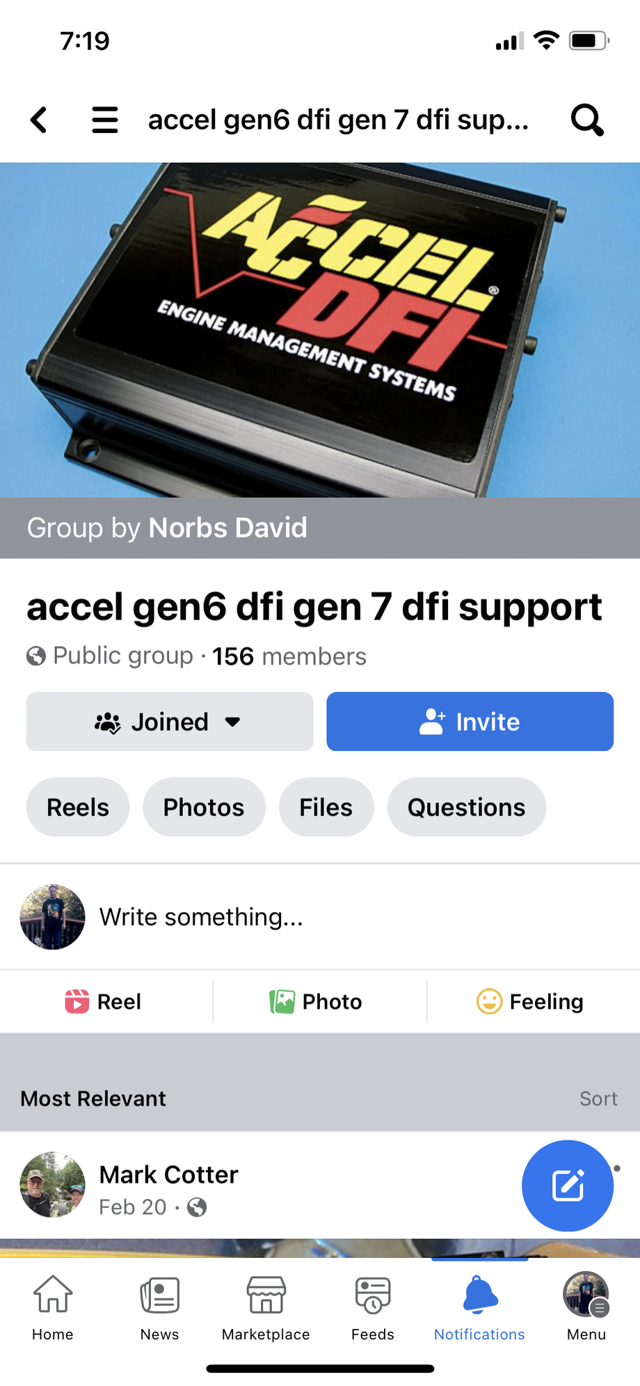

@efiguy iirc this has its own protocol . Need to have the dos based program and com cable to flash or read. It would not be $8d or any xdf to support reading the data. Might ask on this group.
