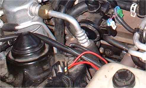

Here is a pic on how the guy wired it. The hot wire from the starter connects here just in front of the strut tower, as does the wire where he spliced into the orange (fan/fuel pump wire?).

Thanks for the replies everyone. That is partially good, the orange is hot, though is it safe to say it is "rigged" by using the constant hot source as a wire coming up from the starter to the fender, where a splice from the orange wire connects. (See pic above). Concerning this is that if this splice is not hooked up in this place the fuel pump never comes on.
So, does that (above) sound like what might be draining my battery in a short amount of time? Or is the power drain likely a different animal?

Check to see where this hot wire is going. Also check the relays and wires for the two cooling fans and fuel pump. They should be attached to the firewall near the brake booster. They could've wired it so that the relays get battery power all the time, eliminating the need for a control circuit.
