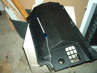

I installed some under the dash and under the seats. Then I just removed the factory courtesy lights and tapped into their wires. That way when the doors are opened or I turn on the interior lights they come on.
In terms of removing the cigarette adapter, there should be a screw holding it together. Then the end with the positive contact will also screw off. The negative wire will be connected to one of the clips that runs the length of the adapter. I prefer to do it this way simply because some manufacturer's use different wiring methods so you can't always go by wire color. Although as Merthman said, it's usually the one with the stripe is positive. Just remember that neon lights are polarity sensitive.
Attached Thumbnails Interior Neons:-neontube.jpg
