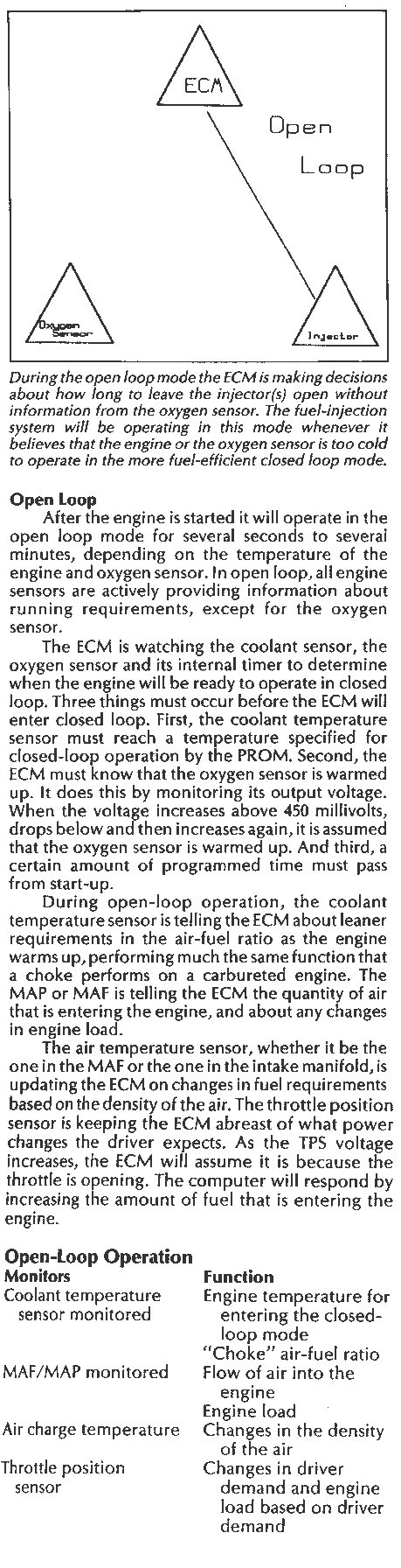

As far as our cars are concerned, code 11 doesn't exist. As for open loop operation, this is easier (and many less typo's) then me typing it out...

Deadbird , thanks for the info. I gotta absorb this and see how it applies. Gonna check out your site too!
