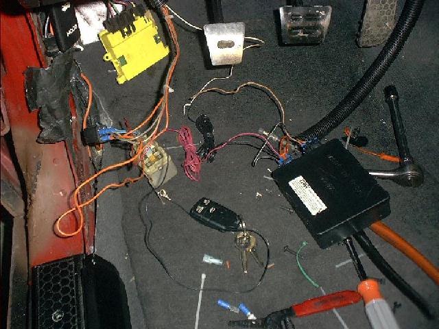

95 camaro setup in my 84 belinetta works good but your going to have to get electrial diagrams for both cars from manuals
Attached Thumbnails Any Strictly Keyless Entry Systems (With No Alarm) (4th Gen Maybe)-remote-setup2.jpg

ok guys i went and bought a gm keyless entry module off ebay. the price was incredible but i was watching that auction like a hawk everyday. i don't know why but i really don't like the aftermarket remotes and have always preferred the GM OEM ones. anyway i'm going to wire it up this weekend/next week and i'll post results and tips. keyless is one of the coolest options ever, imvho
http://cgi.ebay.com/ws/eBayISAPI.dll...tem=2429978239
wish me luck, maybe i can complete this with __max__'s help
