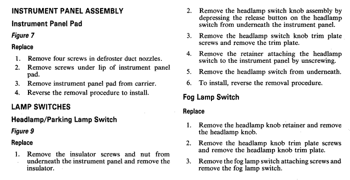

I need to know how to get my old light switch out. I'm talkin about the thing that dims, britens and tunr off the lights. I cant figure it out. Do i need to go thru thhe dah or what???

Hello Jeff,
Your dash is just a tad different than my 89 but this should give you a general idea of what to do.

I got it . i bought a repair manual. wow its a must have.
