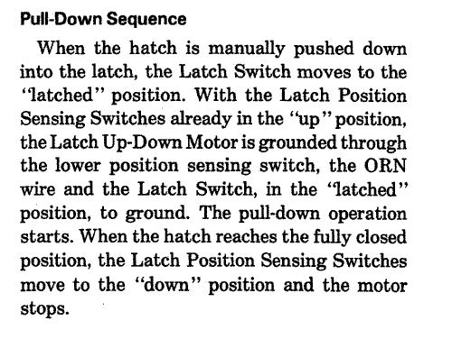

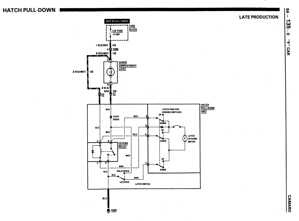

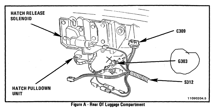

Have you looked at the grounds for the pull down unit. Here is schematic for you to look at.

page 2

page 3
