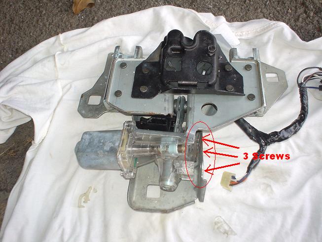

Alright, I was having a problem where my trunk would not stay shut. It drained the battery so I took it to a mechanic. He couldn't get it to work, so he simply took out the light, and disconnected the latch or whatever to hold the trunk shut. Now it's just sitting loose lower down. The trunk is pretty heavy so it stays shut except over speed bumps, but I want to get speakers and need to fix this, anyone ever experienced this, or have any suggestions.
I have never done anything with cars, but plan on starting to learn, this might be a good first project. Any help you can give will be greatly appreciated.

If it's the electric pull down style then maybe the motor housing area where the 3 screws mount to the metal plate on the body cracked off. It's a common problem. It's kinda hard for me to explain but let me give you a pic of mine when it broke. Pm for more info if you find this to be the problem. Pull your panel off & look.

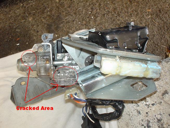

Here's a side pic of the area that cracked. Kinda hard to see though. Also, Lon(TDS) has some good repair kits & parts for the rear hatch lock stuff. Go check it out. That's where I bought my stuff from.

I reinforce the motor housings I sell with aluminum and epoxy where those 3 screws mount it to the frame. Look at the tech article I wrote on this web site on how to repair it. You'll be able to diagnose a broken hatch pull-down motor housing easily once you have the rear hatch surround piece removed. It sounds as if your striker-sensing switch is bad. That is the small black switch that is held onto the latch area with a single phillips head screw. That switch was discontinued by GM last year, but I still have a few available on my web site.
